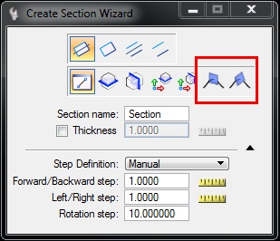

Question:
Can point cloud sections follow an alignment?
Answer:
In the Descartes Create Section Wizard, there are options for "Along Path Vertical" and "Along Path Perpendicular".
