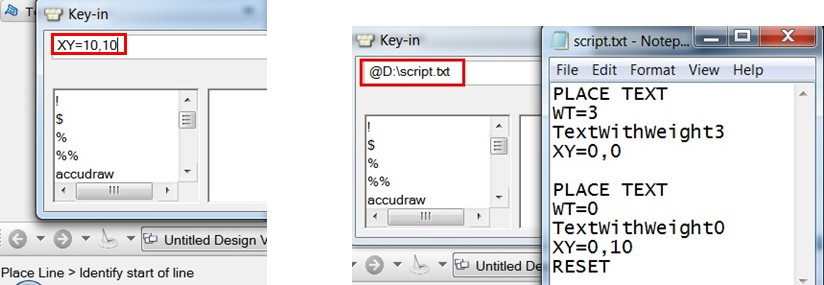

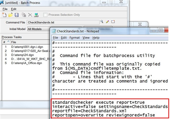

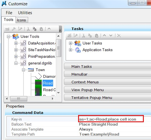

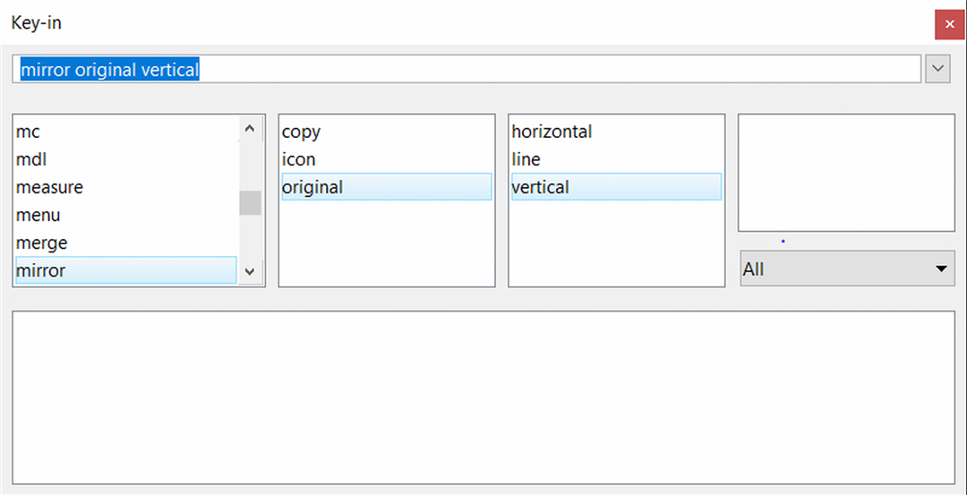

You may have noticed that there are many typing commands in MicroStation. The Key-in icon can be found in the Primary group of the Home card. The Key-in Command dialog box can be opened, where you can browse and execute all currently available key-in commands, as shown in the figure below. Although only four columns are listed in this dialog box, each typing command can consist of more than 4 words.
These typing commands have many uses: for example,
Typing commands is an important link between the MicroStation graphical user interface and background code execution. The four uses of the typed commands listed above are shown below:
MDLCmd1
[1] [2]
[3]
MDLCmd2
[4]

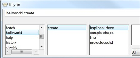

The above command table file defines the following 6 key-in commands, each of which has a corresponding command number. Now create a HelloWorldCmd.h file and add the following:
#define CMD_HELLOWORLD                                     0x0100000000000000UI64
#define CMD_HELLOWORLD_CREATE                              0x0101000000000000UI64
#define CMD_HELLOWORLD_CREATE_LINE                         0x0101010000000000UI64
#define CMD_HELLOWORLD_CREATE_COMPLEXSHAPE                 0x0101020000000000UI64
#define CMD_HELLOWORLD_CREATE_PROJECTEDSOLID               0x0101030000000000UI64
#define CMD_HELLOWORLD_CREATE_BSPLINESURFACE               0x0101040000000000UI64
In the above HelloWorldCmd.r command table file:

4. Return to the command prompt of MicroStation CONNECT Edition SDK and type bmake to generate the project. In the process of generating the project, if any yellow or red prompt message appears, it indicates that there are warnings or errors, which need to be eliminated before the executable ma and dll can be finally generated.
Note: Before executing bmake, you must type mdl unload helloworld into the MicroStation software to unload the loaded application, otherwise an error message will appear during bmake that cannot overwrite the original DLL.
5. Go back to MicroStation and open the Key-in dialog. Type MDL LOAD HelloWorld to load the application. After entering HelloWorld again, you will see the command typing tree shown in the following figure, which corresponds exactly to what we defined in HelloWorldCmd.r. Enter one of these commands and press Enter to draw the corresponding part of the graph.
