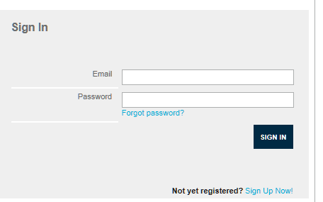

You will have to enter your Bentley Login

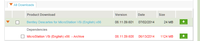

In the Product Download list select the version of Descartes you want to download or have downloaded. (For Example: Descartes 08.11.09.601)
On the left side of the download for Descartes you will see a gray arrow.
Click on the gray arrow and you will see the MicroStation Dependencies for Descartes
You will need to download Descartes if it has not been downloaded and the compatible version of MicroStation installation files.

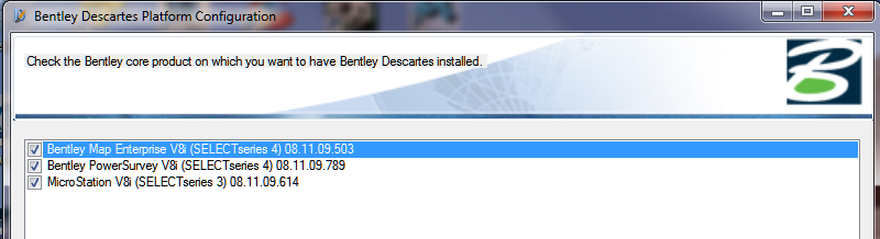

After you have installed MicroStation and Descartes go to
Start > All Programs > Bentley > Bentley Descartes for MicroStation
Select Bentley Descartes Platform Configuration
Make sure all products in the list that will be running Descartes are marked
