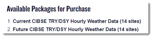

Meteonorm data is the default weather data source supplied with and used in Hevacomp. If CIBSE weather data is required, please see this article detailing how to install it into Hevacomp.

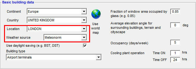

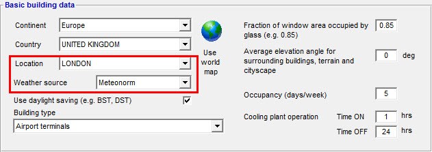

Load the Design Database project. From Building Data, select your buildings location as usual.

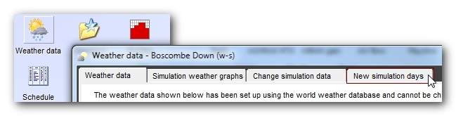

This will determine what locations are available for selection as your Energy Year. To do so, open the Weather Data menu and select "New simulation days".

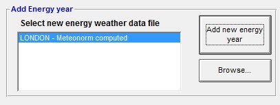

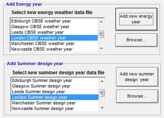

 Select the "Add new Energy year" button.
To set up CIBSE data

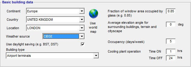

Once your CIBSE weather data is installed, go to the Building Data menu and select CIBSE as the weather source.
Open the Weather Data menu and select "New simulation days".

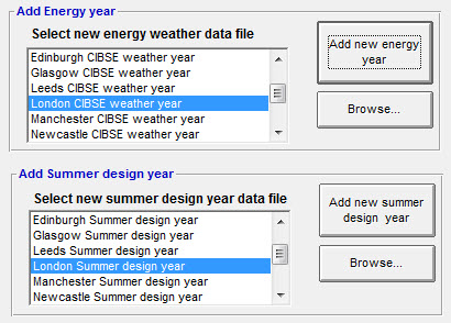

 Select the required location for the Energy year, and push the "Add..." button. If you are asked if you with to overwrite existing data, select yes. Set up your summer design year in the same manner.
