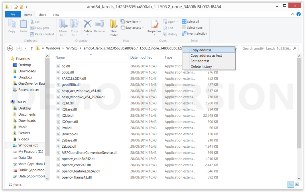

3. Navigate to the Faro SDK installation folder
In Windows Explorer navigate to the Faro SDK installation folder. The name may vary depending on the version of SDK installed but it will be similar to the following:
Right Mouse Click file path then select copy address..

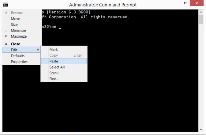

Switch to your command window and on the command line type CD and press the space bar. Next click on the C:\ icon on the top left of the Window and select Edit > Paste and press Enter on your keyboard:
You will now be in the Faro SDK folder

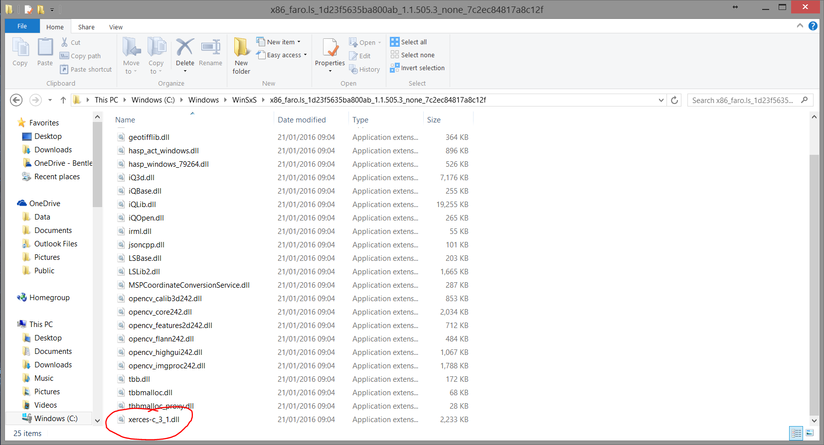

Additional requirements to update Bentley Pointools and the Bentley PointoolsPODCreator
- In the Faro SDK installation folder select the file named "xerces-c_3_1.dll" and copy it to the Bentley Pointools or PODCreator installation folder (this is typically: C:\Program Files\Bentley\Bentley Pointools CONNECT Edition or for the PODCreator: C:\Program Files (x86)\Bentley\Bentley Pointools PODcreator) overwriting the existing file of the same name.
You are now ready to use Bentley Pointools software with the latest version of Faro Scene
