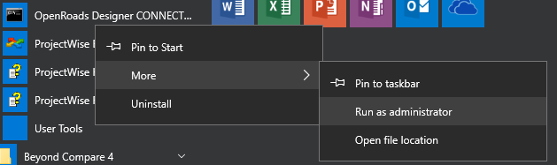

The first step to using the OpenRoads Designer SDK is running the developer shell. This can be found in the Start menu under All apps > Bentley.
Run the OpenRoads Designer CONNECT Edition SDK file as administrator to start the shell. To do this, right-click on the file and select More > Run as administrator.
This will open a command prompt window that serves as the developer shell. From here you can compile examples (and your own projects) that can be run in OpenRoads Designer CONNECT Edition.
