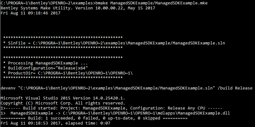

Build a Single Example
To build a single example, use the bmake command and pass it the make (.mke) file for the project. This is the same process for building individual custom projects written by users.
To demonstrate, building the ManagedSDKExample project requires the following command and produces the following output:
bmake ManagedSDKExample/ManagedSDKExample.mke
The output shows that the example built successfully, so now it is ready to run within OpenRoads Designer.

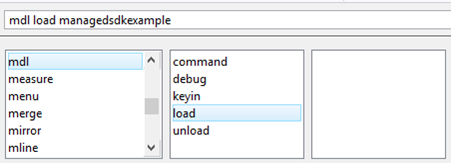

With the files in this location, the project can be found and loaded as a keyin. To do this, open the OpenRoads Designer CONNECT Edition application. Access the keyin menu under the Home tab:
Load the project using the mdl load keyin, passing in the name of the project as the argument. The command to load the ManagedSDKExample project is as follows:
mdl load ManagedSDKExample
If successful, the message “MANAGEDSDKEXAMPLE loaded.” will appear at the bottom of the application in the status bar. The keyin is now loaded and ready for use with the MANAGEDSDKEXAMPLE command. Any further commands specified within the keyin can be run from this root command (this command hierarchy will be explained later).
