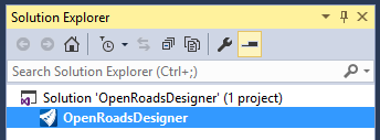

Debugging an Unmanaged Project
Compared to a managed project, debugging an unmanaged project can be tricky. The first step is to compile your project inside the SDK Developer Shell. Once compiled, you can open Visual Studio and follow these steps to debug:
1. Open the executable file for your installed version of Open Roads Designer.
Inside Visual Studio, you can open an executable file just like you can open a solution file – using the dialog under File > Open > Project/Solution. From there, make sure that the file type you’re browsing for is All Project Files:
Now, navigate to your installation of ORD. For example, most users have it installed under their program files:
C:\Program Files\Bentley\OpenRoads Designer CONNECT Edition\OpenRoadsDesigner
In that folder is the OpenRoadsDesigner.exe file, which you should be able to select to open in Visual Studio.
2. Open the files compiled for your project.
When you compiled your project in the SDK Developer Shell, the compiler took the source files specified in your .mke file and compiled them into objects, putting them inside of your installation of ORD. Therefore, make sure any files you want to debug are the files used in that compilation.
3. Start OpenRoads Designer from Visual Studio
Since you loaded the OpenRoadsDesigner.exe file, if you run the “Start” command.
4. Load your command.
From there, you can load your command like normal using the mdl load key-in. You can then place breakpoints in your source code and debug. Note that the break points won’t be loaded until you load your key-in.
