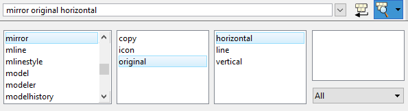

CommandTable.xml
This XML file creates the hierarchy of commands for the keyin. For example, the screenshot below shows three levels of a keyin hierarchy for the mirror command.
In this case, the hierarchy of commands is as follows:
Look at the CommandTable.xml file within the ManagedSDKExample project. This project only has two levels of commands. The top-most level is the managedsdkexample command, created here:

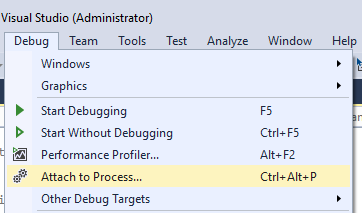

Debugging a Managed Project
A managed project can be debugged through Visual Studio. Open the project using the openSln.bat file and use Visual Studio to build it in debug mode.
The ManagedSDKExample.csproj file is set up to output these build objects directly into the OpenRoadsDesigner installation (see Step 2 of editing the C# project file above). Because of this, the project can be debugged by attaching to a running instance of OpenRoads Designer.
To do this, first launch OpenRoads Designer normally. Once loaded, go to Visual Studio and select
Debug > Attach to Process.
This will open the Attach to Process dialog. From here, make sure to set the “Attach to:” value to “Managed (v4.6, v4.5, v4.0) Code.”
Locate “OpenRoadsDesigner.exe” in the list of available processes, select it, and click Attach. Once Visual Studio has loaded the symbols for the application, it will say Ready in the status bar at the bottom of the screen.
Placing a breakpoint in any of the .cs files in the project will show the error “No symbols have been loaded for this document.” For these to work, return to OpenRoads Designer and use mdl load to load the managed add-in. Doing this will cause Visual Studio to load the required symbols and the breakpoints will work properly. The project can now be debugged.
