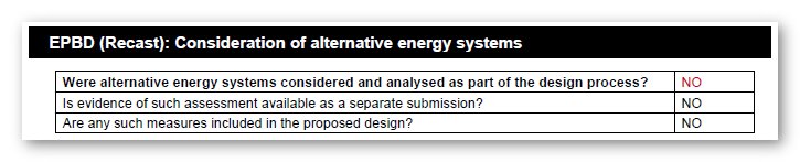

The Part L Compliance Report (BRUKL report) contains a section to indicate whether alternative energy sources are used
![](d18778f11b354690dc6db99f034bcbea.iix)

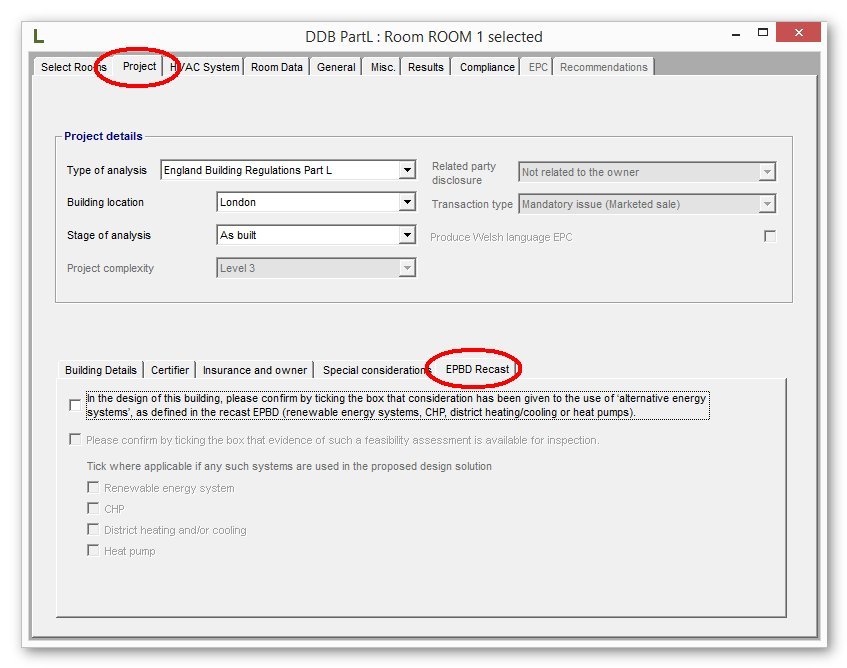

Method
To modify this information please see the Project Tab.
![](bd87bc7947394690e3378d53636d43e7.iix)
![](8687747147f5ca9088c56642846d4351.iix)
