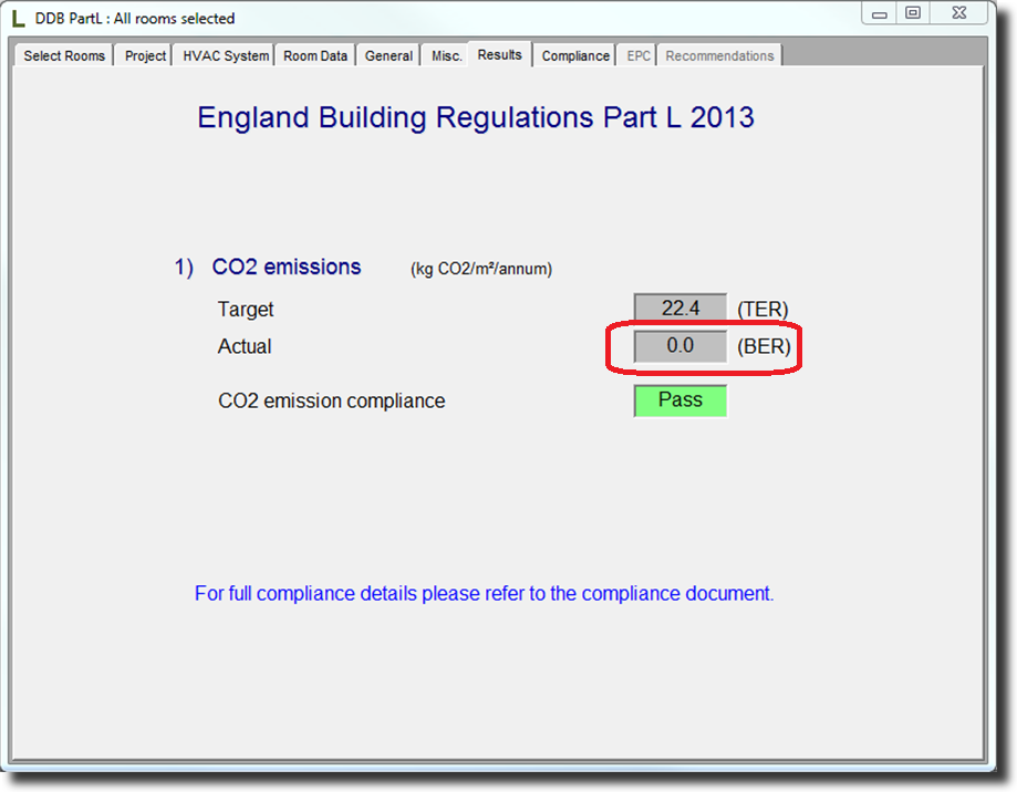

The Part L Results tab shows 0.0 kg CO2/m2/annum for the Actual Emissions Rate.
Method

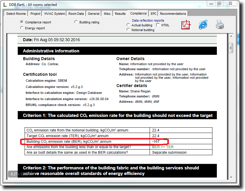

This occurs when the CO2 emissions are completely offset by the benefit of renewable technologies.
Consulting the Compliance Report should provide further insight. For example, the BRUKL document below shows a negative BER result:
