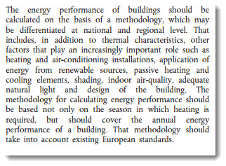

The processes involved in the creation of Energy Performance Certificates and Part L Compliance documents originate from the European Energy Performance of Buildings Directive, which set out requirements in relation to measuring energy usage in buildings.
To achieve this, the Department of Communities and Local Government devised the National Calculation Methodology and BRE were entrusted with developing suitable software.
"The NCM allows the actual calculation to be carried out either by an approved simulation software or by a simplified tool based on a set of CEN standards.
That tool has been developed for DCLG by BRE and is called SBEM - Simplified Building Energy Model"
