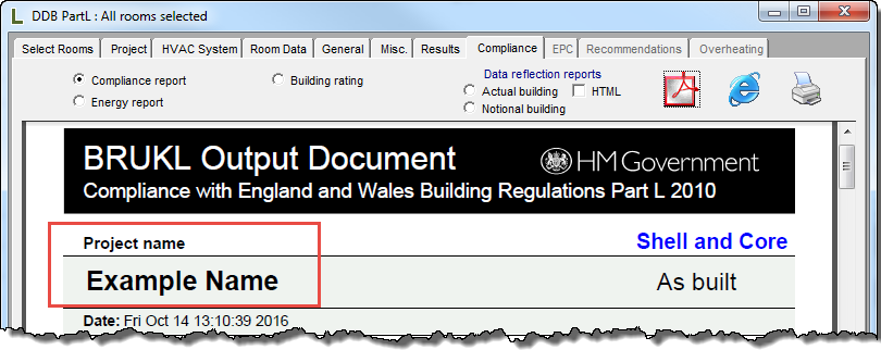

A project name will be displayed at the top of all BRUKL Compliance documents:
![](3b373c711b354690dc6db99f034bcb37.iix)

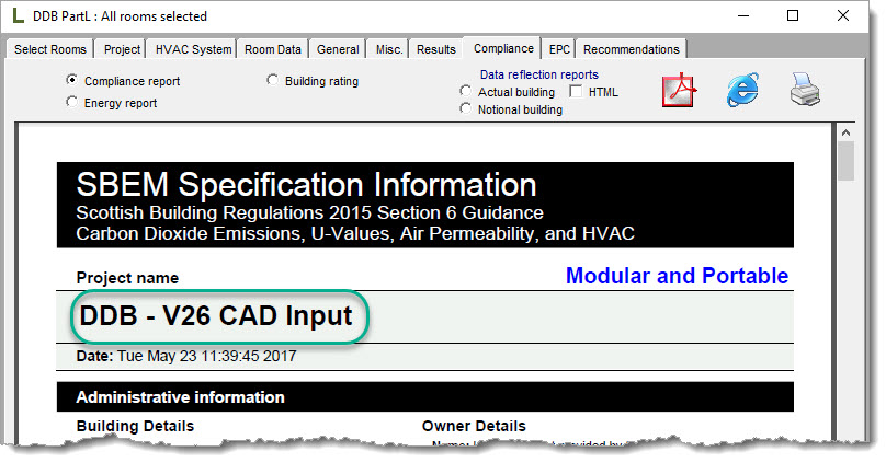

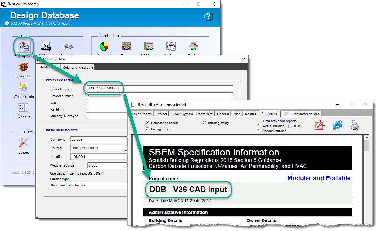

Method
The project name is defined in the Building Data section of Design Database.
![](ec47743947394690e3378d53636d4342.iix)
![](4147743947394690e3378d53636d431d.iix)
