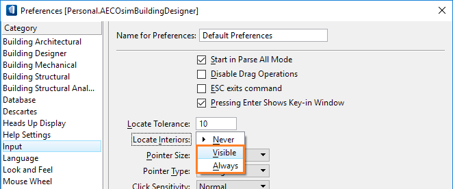

To be able to snap to the mesh the User Preference > Input > Locate Interiors option must be set to either Visible or Always. This allows snapping to locate any point on the mesh surface. This is the most appropriate mode when attempting to locate new elements relative to the mesh.
The exception to this is if the Wireframe Display Style is applied; snapping will then locate any of the points that make up the displayed mesh.
Notes:
AECOsim users: Please note that the default setting for the 'Locate Interiors' option in our delivered preferences is 'Never'. This should be changed when working with Reality Meshes where the element display style is other than Wireframe.
