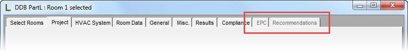

Part L EPC and Recommendations tabs are greyed out, as below.

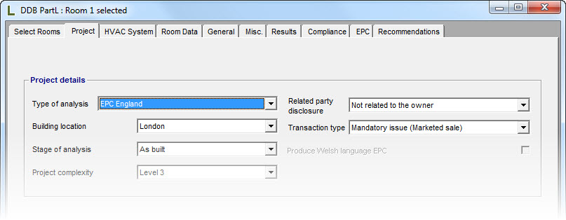

This occurs when the Type of Analysis is set to Building Regulation Compliance. To activate the EPC functions go to the Project tab, and change the Type of Analysis to EPC:
