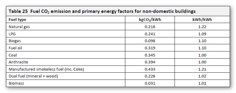

PartL/SBEM has a limited amount of available fuel types. The attached document explains how this pertains to Biofuels.
Bentley Hevacomp's PartL program can only provide fuel options that the SBEM calculation engine can accept. These options (listed here) are from Table 25 of the NCM modeling guide.
