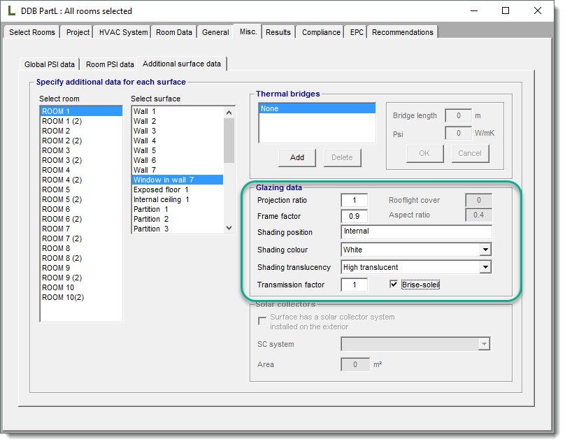

This information can be entered under the "Misc." page in PartL, on the "Additional surface data" tab.

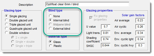

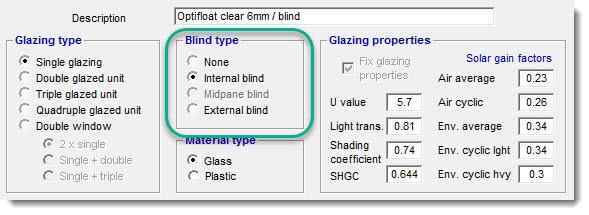

 Once a Window is selected, the Glazing data input becomes active. Please note that, as described in our Glazing Data wiki, the Shading position will depend on the Blind type selecting for that glazing type, within the Glazing Data menu:
 Transmission Factor
A Transmission Factor can be applied to windows to allow overhangs and fins to be considered. This method is taken from the iSBEM manual. Note that Transmission Factor is analogous with Correction Factor in Part L 2010

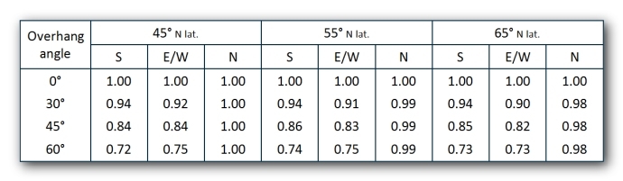

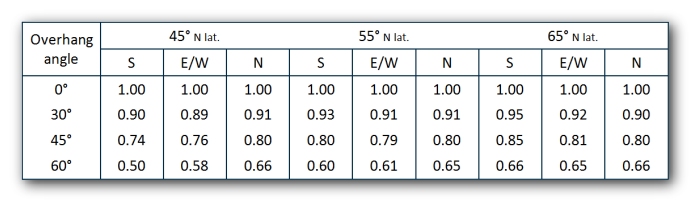

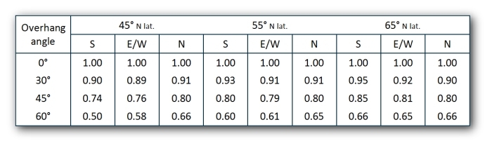

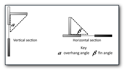

Shading from overhangs and fins
Shading from overhangs and fins depends on the overhang or fin angle, latitude, orientation and local climate. Seasonal shading correction factors for typical climates are given in Tables 10 and 11. The effect of shading from the horizon - ground, trees, other buildings - is not considered by the SBEM calculation engine.
 Figure 43: Shading from overhangs and fins
For the purpose of this calcualtion, the angles alpha and beta (dashed lines) are taken between
the plane of the window and overhand of fin shadow at mid window.
Table 10: Partial shading correction for overhang, Fo Table 11: Partial shading correction for overhang, Ff
