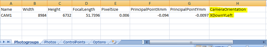

When you import your photos, camera parameters, and GCP from a XLS or XML file, the photos can sometimes be badly oriented.

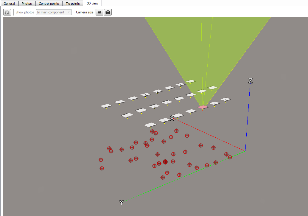

On the example above, the cameras are looking upward instead of looking down at the ground control points.
