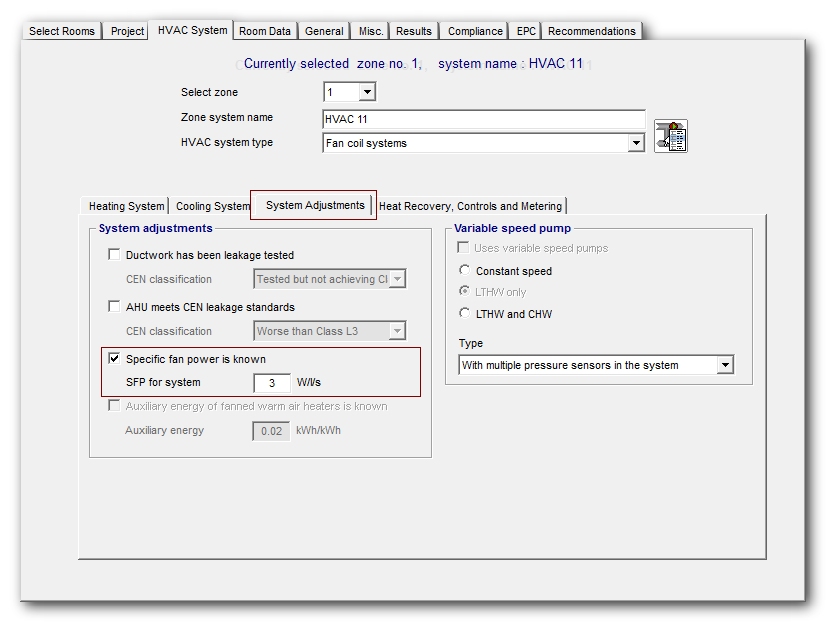

Specific Fan Power for fan coils can be set up to emulate a central air system, or as a room unit.
Method
For Central air handling systems, the specific fan power - where known - should be specified under the System Adjustments tab on the HVAC System screen.
 The specific fan power for individual fan coil units can be defined under Room Data > Night cooling and terminal units.
