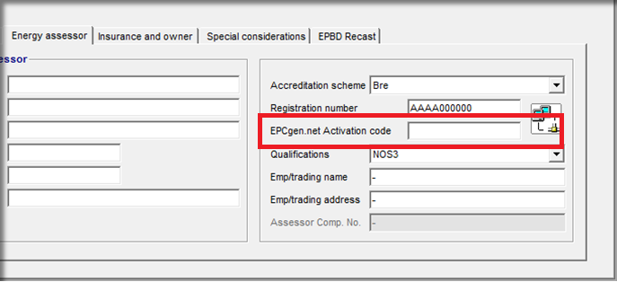

The Energy Assessor section within the Hevacomp Part L Project tab contains a field named "EPCgen.net Activation code", as below:
 Method

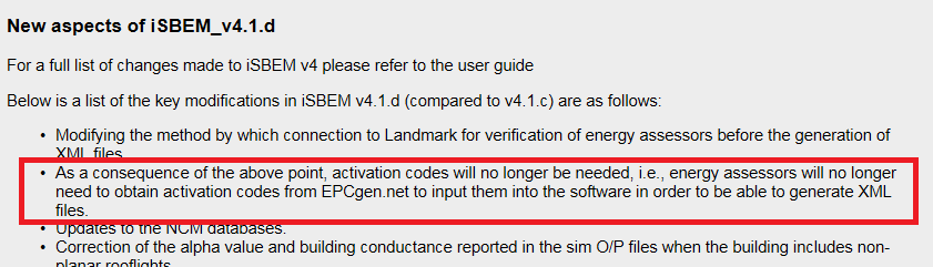

The EPCgen.net code is no longer required in the latest version of SBEM, so this field should be left blank. This was brought into affect upon the release of SBEM 4.1.d. Details from the NCM website can be found below:
