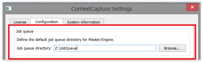

ContextCapture works with the following architecture: the Master module creates and submits jobs that are stored in a JobQueue. The Engine module (if launched) is constantly listening to the JobQueue and processes a job as soon as it is created by the Master and appears in the JobQueue.
After installing ContextCapture, you may encounter problems when submitting your jobs. The JobQueue can either be inaccessible because of permission issues ("fail to submit aerotriangulation") or the Engine module may be listening to the wrong JobQueue ("warning: there is no engine currently listening to the JobQueue")
If you are experiencing such trouble please reset the JobQueue to a directory you are sure to have read and write access (typically the "My Documents" folder is OK).
Changing the JobQueue
Launch CCSettings ("C:\Program Files\Bentley\ContextCapture our_edition/bin/CCsettings.exe").
Go to the "Configuration" tab and browse your new JobQueue. This JobQueue will be listened by the Engine and it will be used by any new projects.

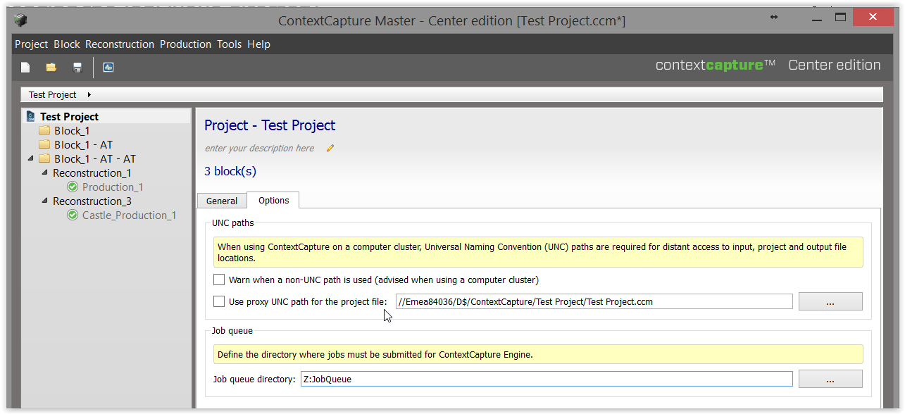

Changing the JobQueue for an existing Project
If you want to change the JobQueue of an existing project, go to the "Options" tab for this project in ContextCapture Master and browse the desired location.
