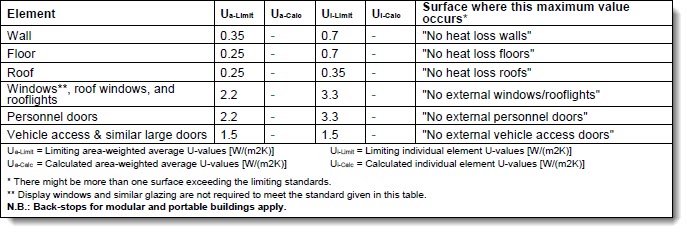

It appears that U-Value checks are not being considered when you view the BRUKL document.
If you are considering a zone with no heating or cooling, the SBEM calculation engine will not check U values.

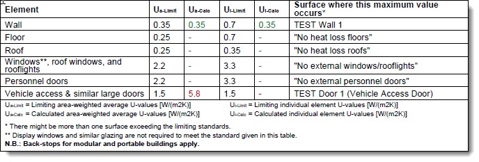

With HVAC defined:
 U value checks are carried out
Without HVAC defined:
U value checks are not considered
