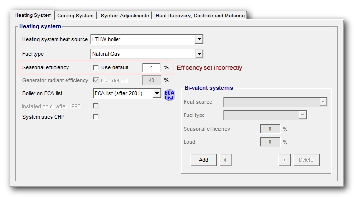

The SBEM calculation has generated a "Keyword out of range: Heat SSEFF" error
Method
This error indicates that one of the Heating systems Seasonal Efficiency has been set to a very low figure. The heating systems should be examined and any incorrect efficiency figures should be changed to a sensible figure.
