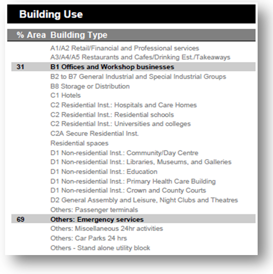

You may see an unexpected building type listed in your BRUKL document
Method
Building Types are determined by the room types available in SBEM, as specified by the NCM database. Design Database contains its own list of room types. Should a Design Database room type not be available in SBEM, then the most relevant room type will be selected - this may fall under an alternate Building or room type
for e.g.: Emergency Services>Workshop would be mapped to  B1 Offices and Workshop businesses
