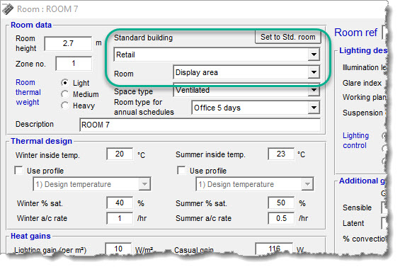

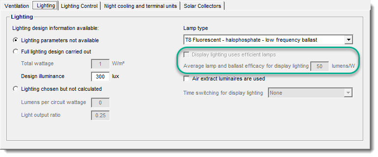

In some instances, efficient display lighting cannot be selected.
 Method
The Display lighting options are only activated if a suitable room type has been selected. The NCM database specifies what room types display lighting applies to. For example, selecting Retail>Display area (as below) will enable these options.
