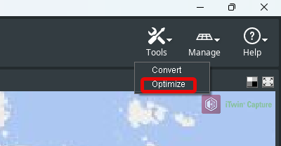

1) Open iTwin Capture Import and Upload Tool
2) In the application window's upper-right corner, click the Tools menu and Optimize.
       *Note: If you only see 3 icons like this image, then install the Optimize Mesh plug-in available at the following link:
                 Optimize Mesh Plug-In: https://kb.orbitgt.com/external/ccgeneratelod
3) Click the Optimize Mesh icon.
