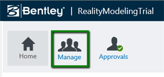

4) Click the "Manage" button:

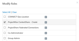

6) Select the user and click "Modify Roles:
7) Toggle ON the "ProjectWise ContextShare - Create" role in the list:
8) Click "Apply":
