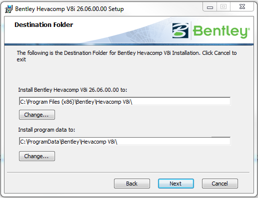

After the initial stages of the installation are complete the following dialog will appear:
In this dialog, set the location for the software and data files to be installed to. It is advised that these be left as default.
Click on Next to complete the installation.
