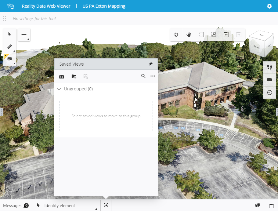

To open the Saved Views dialog
1) Open a Reality Data in the Reality Data Web Viewer.
2) Use the "Views" tool in the Reality Data Web Viewer's status bar at the bottom of the application window.
To create a new saved view:
1) Set up the view the way you want it.
2) Open the Saved Views dialog and click the Create New Saved View icon (camera icon).
3) Enter a name for the saved view.

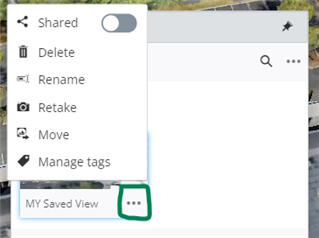

To share a saved view:
1) Open the Saved Views dialog and click the More Actions button (...) next to the saved view you just created and turn on the Shared option.
To open an existing saved view:
1) Open the Saved Views dialog and click the saved view you want to use.
