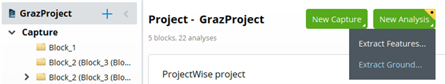

2) Select the project in the in the project tree, then select the “New Analysis” green button and choose the “Extract Ground…” entry.

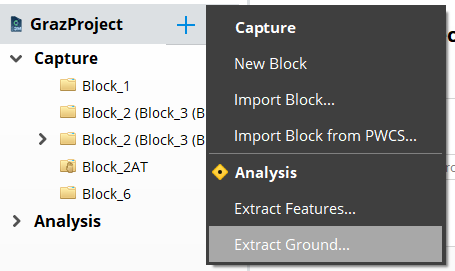

3) In project tree press the “+” button and select the correct entry

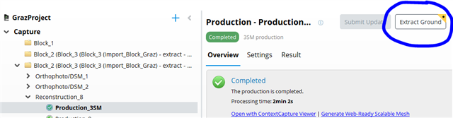

4) Another convenient way of opening this dialog is to select the source capture item directly - for example a mesh production that you already made in this project. By selecting it in the Project tree you will see
the green button “Extract Ground…” in the workflow tool bar. Right clicking on the production item will also show the same entry in the contextual menu.
This latest method has the advantage to already select this production as the source input for the Ground extraction dialog (see Input and settings).
