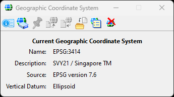

1.)    Define coordinate system to DGN file
2.)    Tools > Geograpics > Select Geographic Coordinate System
3.)    Library > Projected > Singapore
a.       Select EPSG 3414
4.)    File > Save Settings

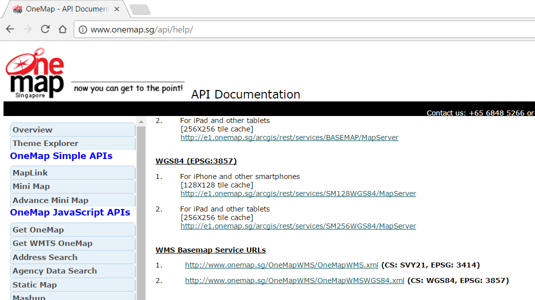

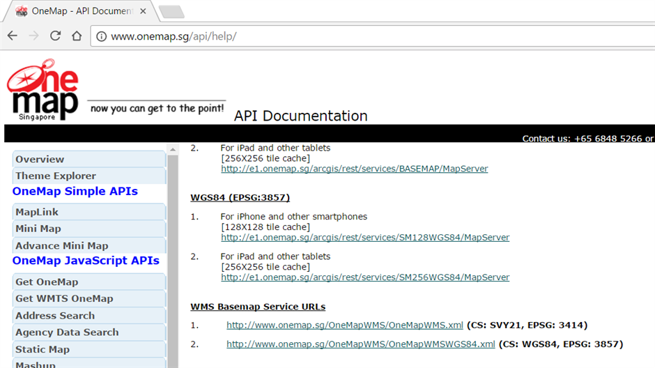

5.)    Open Singapore OneMap website
www.onemap.sg/api/help/
6.)    Scroll down to WMS Basemap Service URLs
7.)    Select XML URL path (Example:  http://www.onemap.sg/OneMapWMS/OneMapWMS.xml )

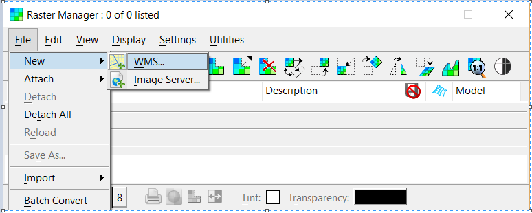

8.)    Raster Manager > File > New > WMS

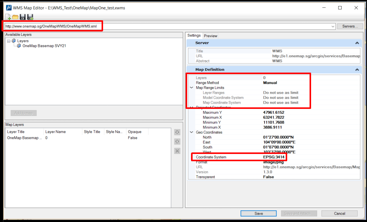

  9.)    Paste URL in Raster - WMS
10.)    Select Map level
11.)    In WMS check the fields that have a red block around them.
NOTE:  Singapore OneMap Data will only work with MicroStation Connect Edition because it is using WMS Version 1.3, which is not supported in earlier releases of MicroStation.
