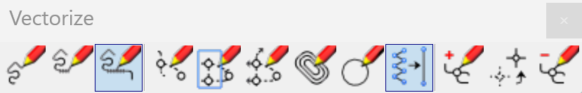

The Vectorize tool box includes a set of enhanced editing tools that support extraction of feature information from images. This tool box can be accessed via the Raster Manager Tools menu or from the Descartes Raster Edit tool box.
Place Element / Continue Element / Insert Element
The first three tools, Place Element, Continue Element and Insert Element, are for placing a new element or continuing or editing an existing one. They are manual and directly controlled by the operator when raster data is not present or not used. They are more or less automatic when raster data is present and used.
Place Element  is used to place a new vector element in the design file and can be used with or without raster data being present.  The resulting element is a complex chain which consist of one or more line string elements and can contain arcs.  Tool settings include:
