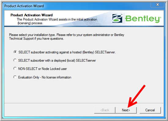

Méthode #1: "Product Activation Wizard"
L'écran suivant est affiché automatiquement quand AutoPIPE Vessel est installé:
 1. Choisir l'option adéquate et appuyer sur Next

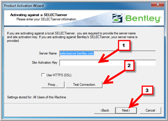

2. Entrer le numéro de clef d'activation et appuyer sur le bouton Test Connection pour vérifier la clef et la connexion au serveur avant de poursuivre l'installation.
NOTE: Si l'écran n'est aps affiché, contacter le département Bentley Licensing pour obtenir de l'assistance.

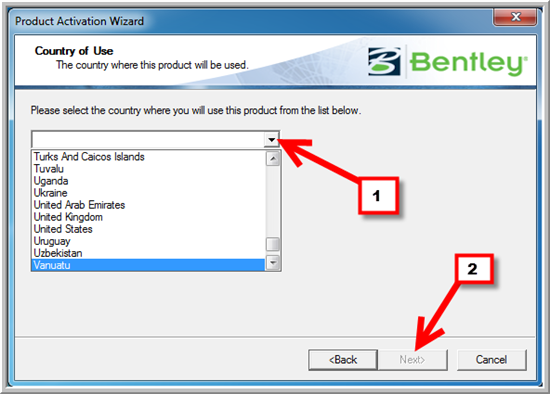

3. Choisir le pays et appuyer sur Next

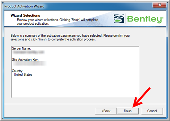

4. Vérifier si les informations sont correctes at appuyer sur Finish:

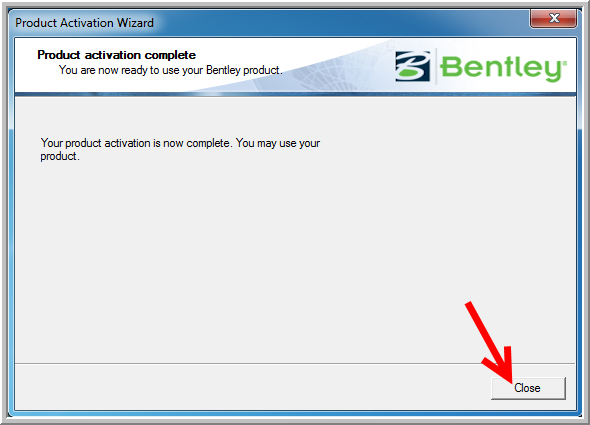

5. Si tous les paramètres sont corrects, l'écran suivant apparaît:

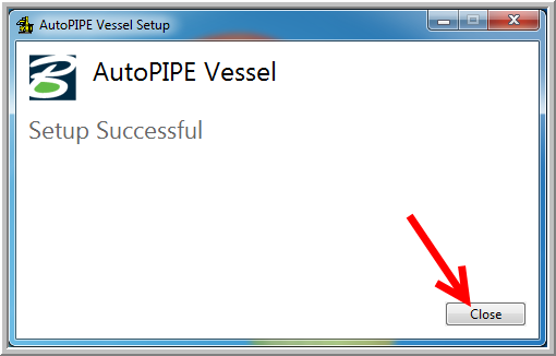

Ultimately the following is displayed:
L'installation d'AutoPIPE Vessel est terminée !!!

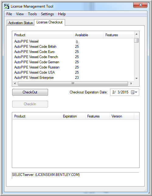

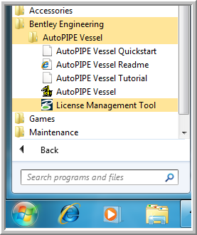

Review Licensing before starting the program for the first time
Select Start> Bentley Engineering> AutoPIPE Vessel> License Management Tool>
Look at the column next to the version of AutoPIPE trying to license, see the following image:
Is the value = 0 ?
If the value is = 0, then you cannot use this version of AutoPIPE Vessel as it does not have a valid license.
You may consider increasing your pooled license, contact your Bentley Account Manager for options and pricing, Or Contact Bentley license team to help locate the user who has the license checked out.
Is the value >0 ?
If the Value is greater than 0, therefore a license is available for the application.

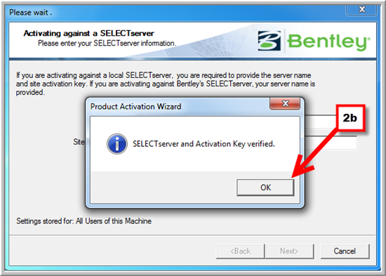

b.  Select Tools> Options> Press the test connection button, the following should appear
SELECTserver
SELECTserver and Activation Key verified.
OK
if not, then your computer is not connecting to the server location, check the server name and activation key again or Internet connection may be down.

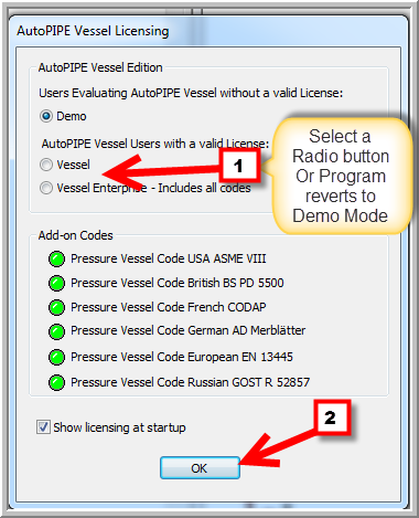

Start the Program - AutoPIPE Vessel
Start the program by selecting the desktop Icon, or by selecting:
Start Button> Program> Bentley Engineering> AutoPIPE Vessel > AutoPIPE Vessel.
If everything was correctly installed and licensed the following should be displayed, select a valid license option per the available licenses indicated above and press OK button to use the program:

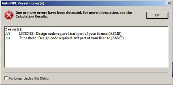

2. The following is displayed:
Answer: The program is in Demo Mode, correctly license the application. From within AutoPIPE Vessel select File> License Settings> choose a radio button that allows the use of the function trying to analyze under.

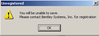

3. The following is displayed when running application:
Answer: The problem is that you do not have the correct license available to use this feature of the program.
