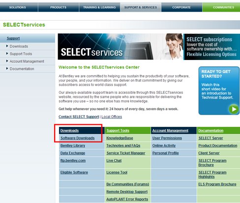

1. Open internet explorer web site http://selectservices.bentley.com/en-US/
A. Select "Support & Services" Tab
B. Select "Support"
C. Select “Software Downloads”

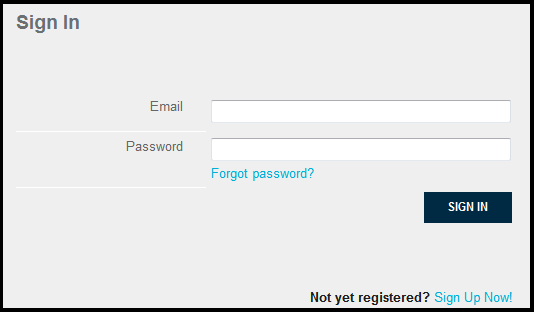

D. Log into web site.
Note: If you do not have a current log, in please contact your local Bentley site administrator who can assist you with the correct information and permissions.

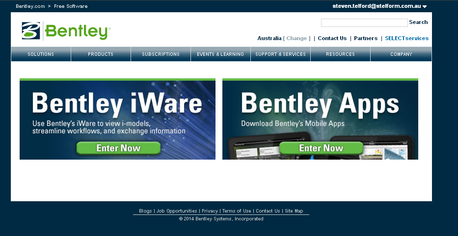

This may happen if a user's Bentley login is missing the Software Download role. Please visit the User Profile page: https://ims.bentley.com/IMS/Profile/ Expand the Access Levels section, and verify that "Yes" appears on the Download line.
If No appears, then please contact your Bentley onsite admin and ask to be upgraded with download ability.
If Yes appears, but you saw the image above for "Bentley I-ware / Apps", then please contact the Bentley License Team, there is a problem with your account settings for Account identification vs Account Overview on our server. Once this has been updated correctly only then you will be able to download without any problems.

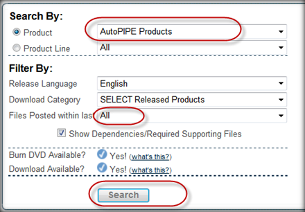

1. In the “Search By:” area, Select radio button next to “Product”, and select “AutoPIPE Products” from drop down list
2. In the “Filter By” area, “Files Posted within last”, change from “6 months” to “ALL”.
3. Press the “Search” button at the bottom of the web site

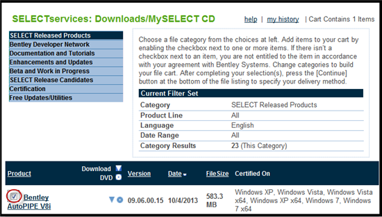

4. Select the version of AutoPIPE to download by placeing a check in the box next to the name and confirm that any dependencies have also been selected.
Note: The following screen shot may show different versions then currently available, but the steps to download
are the same. Select a version to download. If you do not see check boxes next to the applications, you do not have download rights. Options for procedures to update your user access:
Note: Far right column notifies you of the OS for which the application is certified on. Installing the application on any other OS will be at your own risk and will not be supported

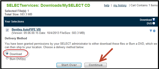

6. Select Delivery method, Default Download, you can chose Download or Burn CD (an official CD will be mailed). Press “Continue” button
a. Selec the Radio button for "Download" and press "Continue" button.

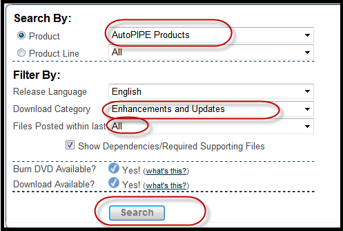

1. Use the instructions above to log on the Bentley web site and navigate to the Support Download web page.
2. In the Search By area, Select radio button next to “Product”, and select “AutoPIPE Products” from drop down list
3. In the Filter By section, change "Download Category" to "Enhancements and Updates", and “Files Posted within last” to “ALL”
4. Press the “Search” button at the bottom of the web site
5. Place a check in the box next to the name and confirm that any dependencies have also been selected.
6. Press “Continue” button
7. Select Delivery method, follow steps above for procedure to Download or Burn DVD(s).
