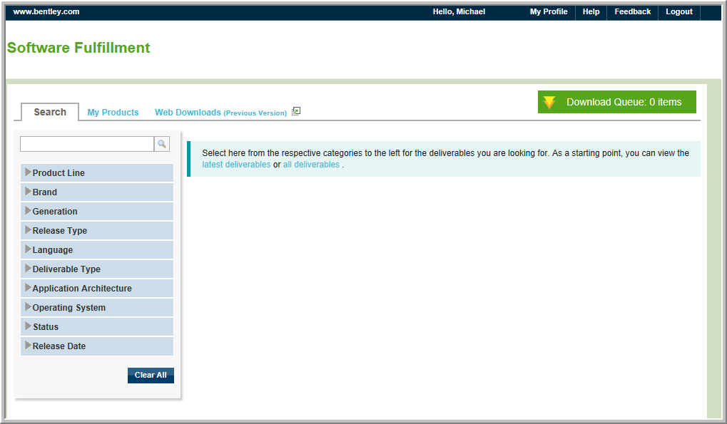

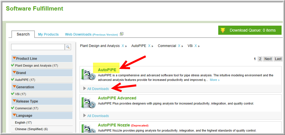

In May 2014, Bentley launched a new method of downloading all of Bentley's software using a web page called Software Fulfillment (imaged bellow).
The Web site is accessed by using the following procedure:
If you are part of the QA&R program, any installation from a downloaded file for AutoPIPE or ATS is strictly forbidden and does not constitute a valid installation or verification. All QA&R user must install the applications from the CDs received from Bentley systems QA&R manager

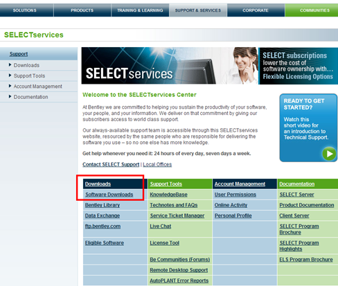

1. Open internet explorer web site http://selectservices.bentley.com/en-US/
A. Select "Support & Services" Tab
B. Select "Support"
C. Select “Software Downloads”

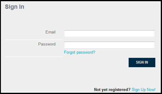

D. Log into web site.
Note: If you do not have a current log, in please contact your local Bentley site administrator who can assist you with the correct information and permissions.

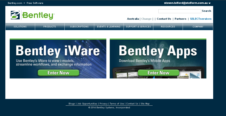

This may happen if a user's Bentley login is missing the Software Download role. Please visit the User Profile page: https://ims.bentley.com/IMS/Profile/ Expand the Access Levels section, and verify that "Yes" appears on the Download line.
If No appears, then please contact your Bentley onsite admin and ask to be upgraded with download ability.
If Yes appears, but you saw the image above for "Bentley I-ware / Apps", then please contact the Bentley License Team, there is a problem with your account settings for Account identification vs Account Overview on our server. Once this has been updated correctly only then you will be able to download without any problems.
The following Web page should open up:
If not use the following hyperlink here.
Again, if you are unable to see the web page shown above, we apologize for the inconvenience, however you must use the older download method, select the following link here for instructions.

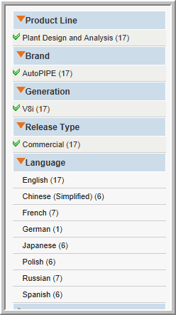

Select the following settings:
Product Line = Plant Design
Brand = AutoPIPE
Generation = V8i
Release Type = Commercial
Language = Select the correct language from the available listing (English, Chinese, French, German, Japanese, Polish, Russian, Spansh), This procedure will assume English to be selected.
AutoPIPE is available in 3 different versions (i.e. Standard, Advances, Nuclear) and has 2 add ons (StessIso Add-on and KHK2 Add-on). These versions and add-ons are controlled by the license available in your License Management Tool. Therefore, all you need to do is download the software labeled "AutoPIPE" as shown below. The installation process will install the complete program. Again, these program features are controlled by the license:

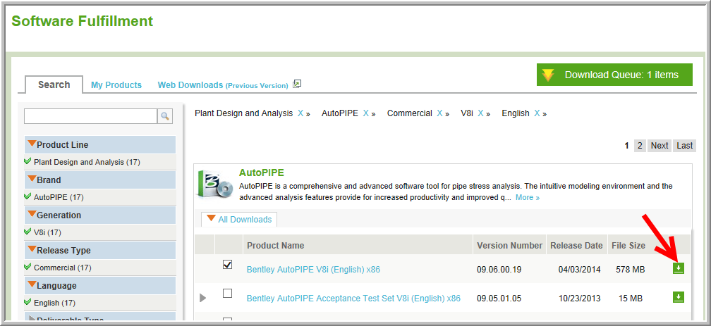

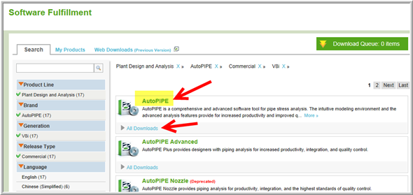

Select the hyperlink labeled "All Downloads" under "AutoPIPE" to see a listing of available versions to download.
Locate the version number to download (most recent version is listed first and descends to lower versions of the application).
At the end of the line, to the right of the version number, select the Green box to download the application.
Note:
1. The screen shot above may show different versions then currently available, but the steps to download are the same. Select a version to download. If you do not see check boxes next to the applications, you do not have download rights. Therefore your options to update your user access rights:
2. Again, you do not need to download any other software for installing AutoPIPE on your computer.
