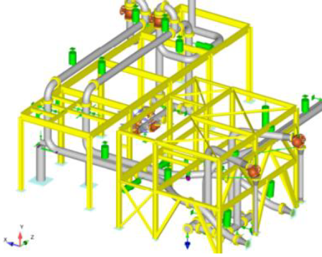

Bentley AutoPIPE is a comprehensive and integrated piping analysis and design solution including a state-of-the-art CAD-like graphical interface with unique object technology, fast analysis, realistic animation and visualization tools, and international design codes.
Bentley AutoPIPE enables users to create, modify, and review piping and structural models and their results quickly and easily while offering advanced linear and non-linear analysis capabilities under static and dynamic conditions like temperature, wind, wave, buoyancy, seismic, and transient loadings.

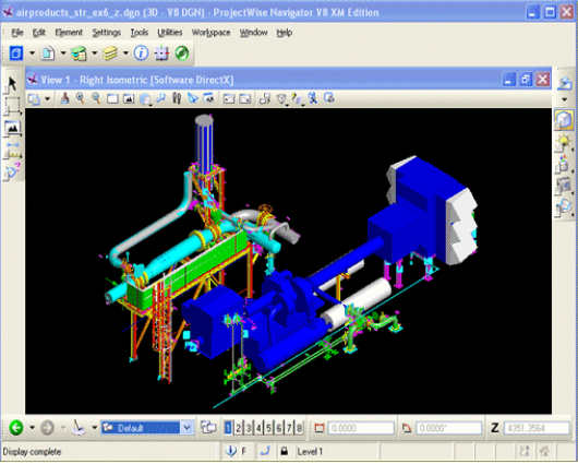

Anyone on a project team for the first time in Bentley Navigator can view a detailed piping or structural analysis model complete with all the modeling and result data alongside the "real-time" 3D CAD model in order to make early design decisions and avoid costly mistakes. Using ProjectWise collaboration servers, distributed engineering is now possible with remote teams around the world.

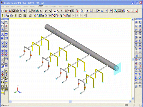

Bentley AutoPIPE also offers graphical copy and paste functionality for quick modeling and the ability to deal with changes in a timely manner.

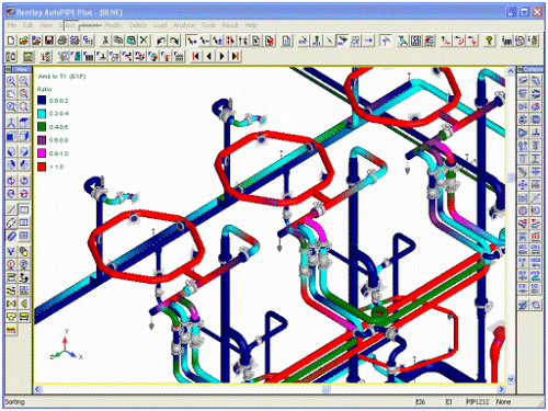

Intuitive GUI modeling
AutoPIPE offers an always present graphical user interface that enables the user to dynamically input graphically for faster modeling and modifications. Our one screen CAD-like graphical environment is the most intuitive in the industry, with 3D OpenGL rendering and smart component graphics for realistic animation and visualization.

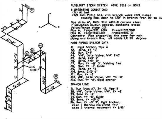

Figure 1

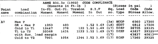

The piping system has two operating conditions to be analyzed. The first one is all hot (T1), and the second condition (T2) is when the valve at node. B2 is closed, thereby resulting in a cool down of the branch line from 600°F to 120°F starting at the valve, and a change in the externally imposed displacement at anchor node B6 from 1" growth in the Y direction in the first thermal condition case (T1) to only 1/10" growth in the Y direction in the cool down condition case (T2).
Please remember that the ASME B31.1 and B31.3 piping codes require a stress range to be calculated not only from ambient to thermal condition 1 (cold to T1) and ambient to thermal condition 2 (cold to T2), the codes also require that a stress range be calculated between the two operating conditions (T1 to T2).
As you can see from the analysis results (see Figure 2), the worst case B31.3 piping code stress calculated by AutoPIPE was in stress range case T1 to T2 at branch point A7 with a 43,837 psi stress that failed piping code compliance. You can quickly input and analyze this system for yourself with another piping stress program. Results from piping stress analysis programs other than AutoPIPE will likely show that the system passed code compliance with only about 26,700 psi stress (compared to 43,837 psi!) at branch point A7, when in fact, the system was considerably over-stressed at that branch. Run the same analysis using ASME B31.1 and you will see an even larger disparity between AutoPIPE and other piping stress programs.
Why would other piping stress programs differ from AutoPIPE by such a wide margin in the calculation of B31.1 and B31.3 piping code stresses? Answer: Some programs are limited to only one (1) set of anchor displacements and one (1) set of support displacements, no matter how many thermal operating conditions must be analyzed. Since equipment grows or shrinks depending on thermal conditions, such a limitation on anchor/support displacements can have a profound impact on the calculation of piping code stresses when more than one thermal operating condition is analyzed. Other piping stress programs are incapable of calculating a stress range between multiple thermal operating conditions (some can't calculate the Tl to T2 code compliance case).

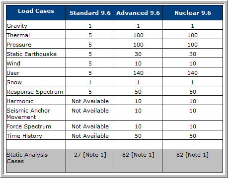

In one analysis, AutoPIPE will automatically perform piping code compliance, calculating stress ranges with up to three (100) sets of temperatures and pressures using different anchor and support displacements for each different thermal condition. In the same analysis, AutoPIPE will analyze support and equipment loads with consideration of multiple wind directions, multiple earthquake loads, and up to 13 dynamic occasional loads. AutoPIPE output displays the greater of earthquake stress and wind stress at each point, while summarizing all loads on each restraint and equipment nozzle with rotating equipment compliance in one analysis. If your piping stress software does not perform these functions automatically, then you can determine for yourself how many problematic piping code compliance stress calculations may have been made, and how many man-hours have been spent running separate jobs. Bentley strongly emphasizes the CAD interfaces offered by AutoPIPE for AutoPLANT, PRO-PIPE. Intergraph PDS and other plant design systems. Although AutoPIPE's commitment to CAD interfaces is a strong benefit for users, it is often overlooked that AutoPIPE provides important stand-alone capabilities not available with other piping stress programs, enabling users to more quickly and reliably analyze their piping systems.
Attention: For current specs on AutoPIPE capabilities, please see the following AutoPIPE help section:
Help > Contents> Contents Tab> Getting Started> AutoPIPE V8i Standard vs Advanced vs Nuclear.
Example: AutoPIPE V8i 09.06.01.10:
Note:
Maximum number of load cases that can be analyzed in a single analysis set during a static analysis run in v9.1 and later. However an unlimited number of analysis sets can be run in a single static analysis in v9.1 and later.
= Gravity (1) + Thermal (20) + Pressure (20) + Static Earthquake (20) + Wind (10) + Snow (1) + User (20)
= 83 cases for Advanced & Nuclear (28 for Standard)
Up to 100 different thermal loadings can be defined and analyzed in a single static analysis. Only 20 thermal load cases per analysis set e.g. if want to run 50 thermal cases then define across 3 analysis sets. Since each analysis set can have analyze up to 82 static cases, so literally 100’s of loads can be analyzed in different scenarios with different options, linear, non-linear, hot or cold modulus etc in the same static analysis run.
