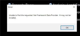

After installing RAM Structural System version 17 or later and signing into the Bentley Connection Client, the RAM Manager opens and a new file can be started, but RAM Modeler module fails to open for a new or existing file. When clicking the button or menu option the cursor spins briefly, but nothing happens. On some machines the following error may occur for brand new file (Unable to find the requested .Net Framework Data Provider):

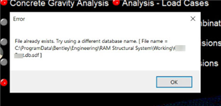

Opening an existing file may just spin or given the following error (File already exists...file.db.sdf):

We believe the problem relates to some incompatibility in the shared Microsoft components included in the Microsoft .NET Framework, SQL Server Compact Edition and/or Visual C++ Redistributables. To solve the problem follow these steps after creating a Windows Restore Point. We are looking into less invasive ways to restore functionality, but Windows 7 will not be supported much longer.
