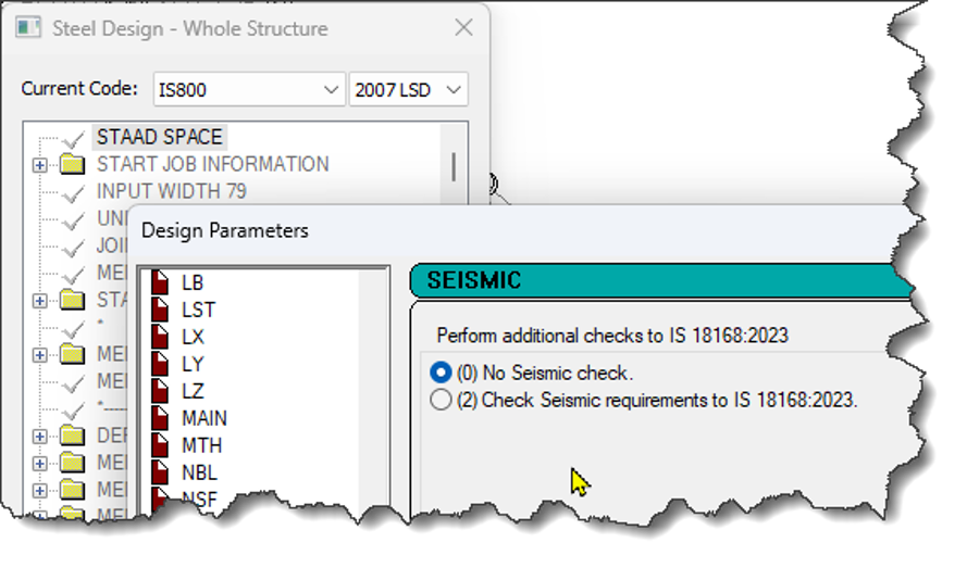

Seismic Design
The design requirements for earthquake-sensitive structures in India have been updated. While engineers previously relied on Section 12 of IS 800:2007, the requirements are now governed by a newer publication: IS 18168:2023, Earthquake Resistant Design and Detailing of Steel Buildings — Code of Practice.
Designing steel structures in India now requires the framework to be evaluated against both IS 800:2007 and IS 18168:2023. To support this, STAAD.Pro now incorporates systematic capacity-design and seismic performance checks to ensure the predictable inelastic behaviour of steel members during strong ground motion.
To complement these new capabilities, a new set of material definitions has been added. This allows engineers to easily assign the appropriate, code-compliant steel grades to their models.

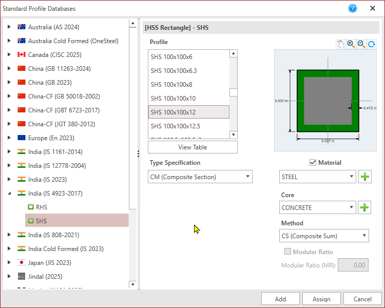

Composite Column Modelling and Analysis
A growing trend in modern construction is utilizing the strength and fire-resistant properties of concrete in conjunction with structural steel profiles. Beyond the clear structural advantages, composite columns also deliver significant architectural and economic benefits.
What does this mean inside STAAD.Pro? To support this trend, tubular profile definitions have been extended. You can now specify that the core of a hollow profile is filled with a concrete material. The analytical properties of the resulting composite profile are then calculated using the composite sum method, with an alternative equivalent section method also available as an option.

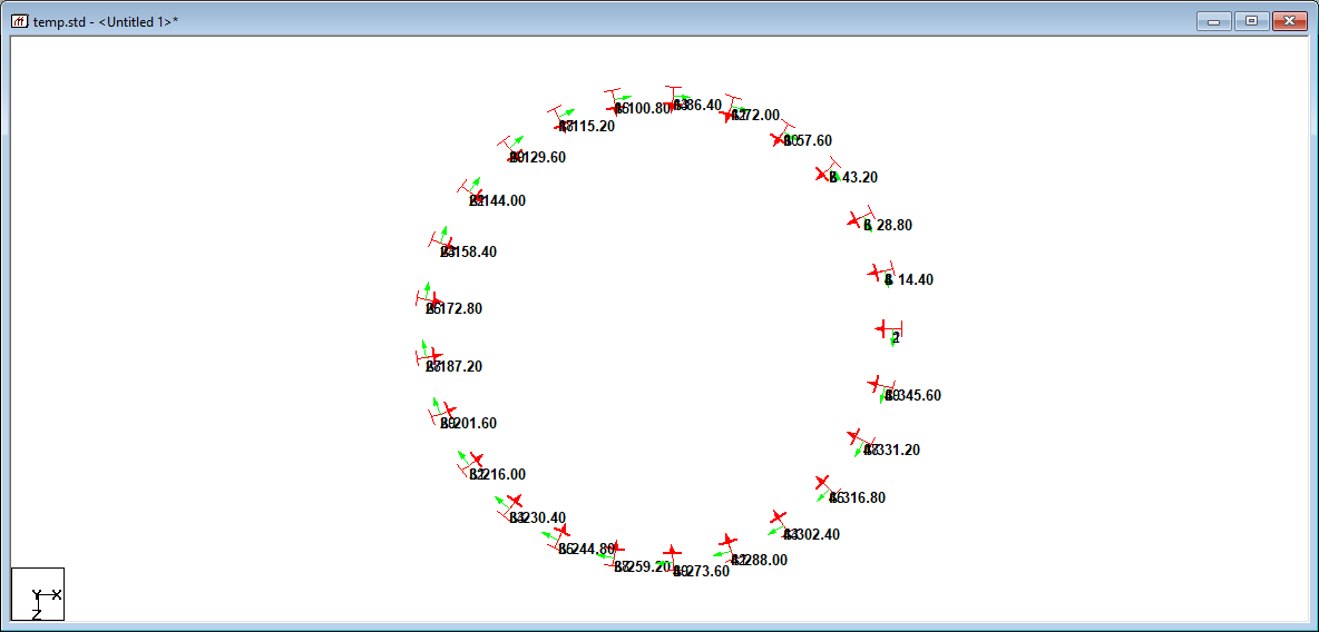

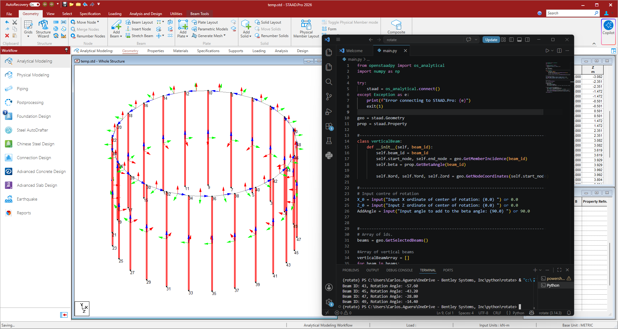

To support the growing adoption of Python as a primary scripting tool for engineers, STAAD.Pro 2025 introduced a Python implementation of OpenSTAAD.
For example, you can use a Python script with the openstaadpy package to address requirements that aren't available as default tools in STAAD.Pro—such as dynamically aligning the local Y-axes of columns to a given 3D coordinate.
Just like that, a simple script can significantly expand your program's functionality!
(If you would like a copy of this Python script, leave a comment below.)

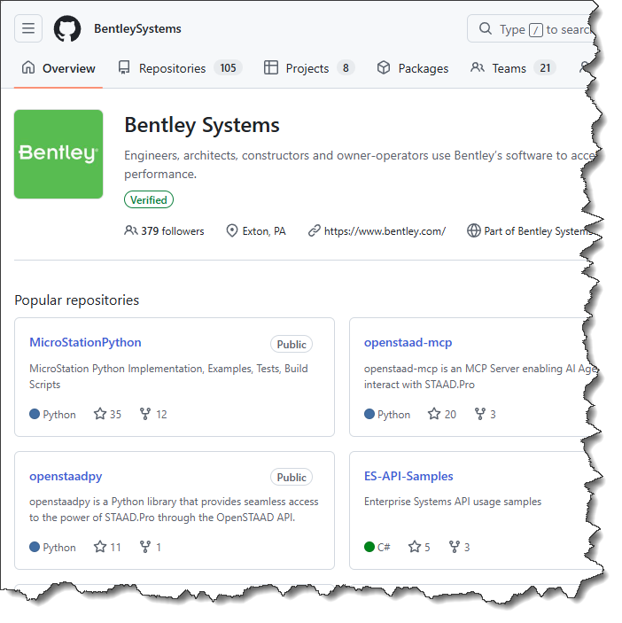

There are as many use cases for productivity-boosting scripts as there are engineers, and the power to solve those use cases is now delivered directly to you in a Python package. All the functions that were previously only available as COM objects for VBA are now included as a Python package delivered with the program.
Want to build a solution outside of STAAD.Pro? You can! openstaadpy is a freely available, open-source package accessible on GitHub:
BentleySystems/openstaadpy: openstaadpy is a Python library that provides seamless access to the power of STAAD.Pro through the OpenSTAAD API.
Complementing this solution is a new MCP server that empowers your local AI service with STAAD-specific skills. By downloading and installing the MCP server, you can simply describe your STAAD requirements to your digital assistant, which will then automatically generate the necessary scripts for you, saving you even more time.
BentleySystems/openstaad-mcp: openstaad-mcp is an MCP Server enabling AI Agents to interact with STAAD.Pro

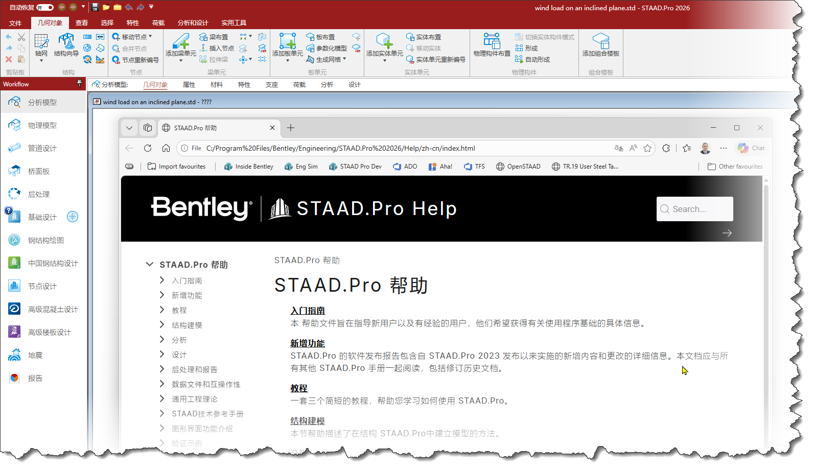

Chinese User Documentation
A new method for providing user documentation based on the language setting now allows engineers who operate STAAD with the Chinese interface to access the localised help documentation directly from within the application.
Indian Steel Profile Databases
Updated to latest editions of IS 808, Hot Rolled Steel Beam Column Channel and Angle Sections - Dimensions and Properties and IS 4923, Hollow steel sections for structural use.
