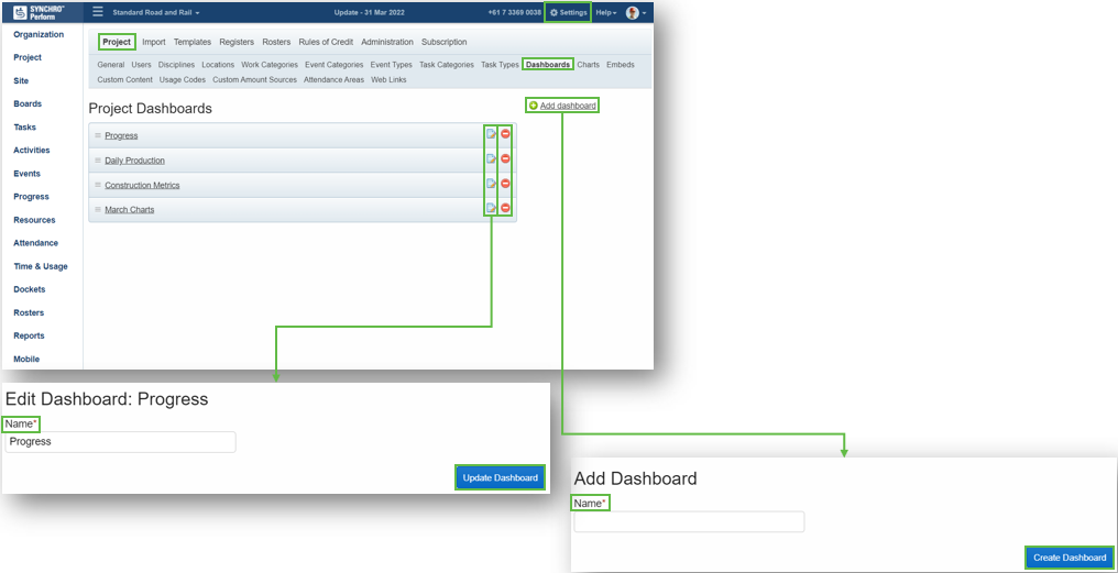

Dashboard and Charts configuration
Create Dashboard
Dashboards are used to display Charts and Embeds that provide project insights.
  1. Click on Settings > Project > Dashboards.
  2. To create a dashboard, click on Add Dashboard.
  3. Enter the dashboard Name.
  4. Click Create Dashboard.
  5. To edit a dashboard name, click on  , change the dashboard Name and click Update Dashboard.
  6. To delete a dashboard, click  .
  7. To re-order the dashboard, click on   and drag the dashboard to the desired position.

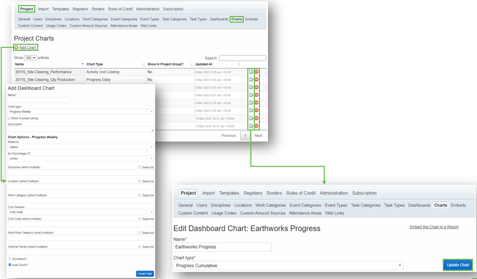

Create Chart
Charts can be used to visualise cost and progress data.
  1. Click on Settings > Project > Charts.
  2. To create a chart, click on Add Chart.
  3. Enter the chart Name.

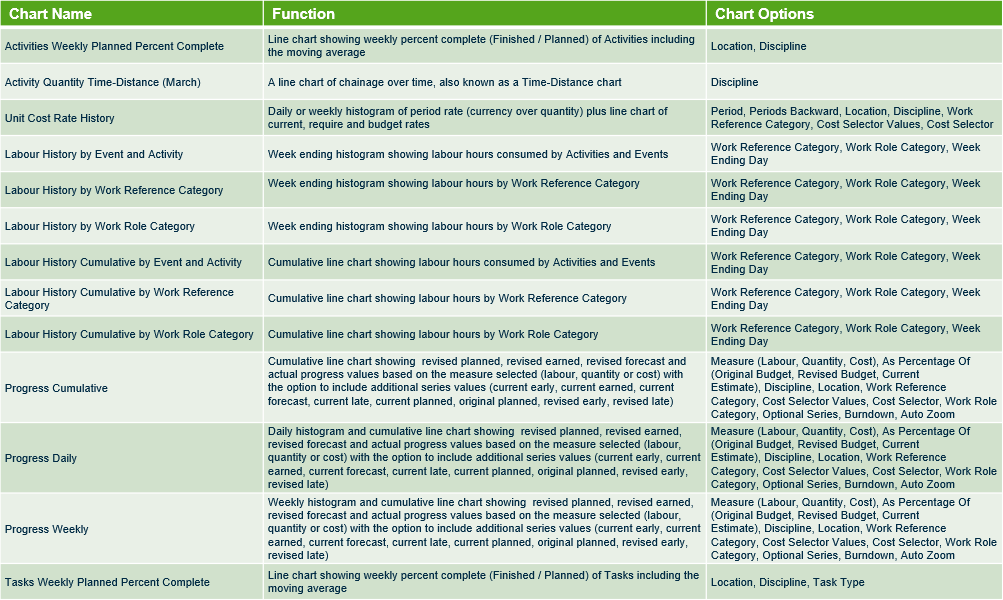

  4. Select the Chart type (refer to below table).
  5. Populate the Chart Options.
  6. Click on Create Chart.
  7. To edit a chart, click on  , make changes to the chart and click Update Chart.
  8. To delete a chart, click  .
Chart Types

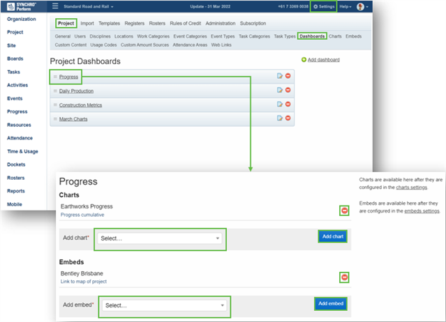

Add Charts and Embeds to Dashboards
Charts and Embeds must be added to one or more Dashboards for display within SYNCHRO Perform.
  2. Click on the name of the dashboard to add a chart or Embed.
  3. To add a Chart, select the Chart Name from the dropdown list and click Add chart.
  4. To add an Embed, select the Embed Name from the dropdown list and click Add embed.
  5. To remove a Chart or Embed from the Dashboard click the   icon next to the Chart or Embed name.
  6. To view the Dashboard, go to Project > Dashboard in the Perform menu.
Note: Charts and Embeds appear in the Dashboard in the order they are added. To re-order the Charts or Embeds you need to remove them and re-add them using the process described above.
