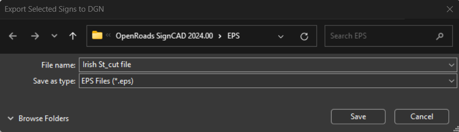

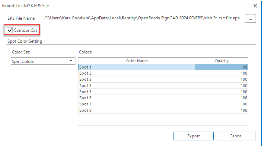

Step 3: In the Export to CMYK EPS File dialog, press the button with the three dots to the right of the EPS File Name, enter a File name and press Save.
Step 4: Check the Contour Cut box and press Export to generate the EPS file.
Step 5: Bring the saved EPS file into your cutter/plotter software to cut the sign.
