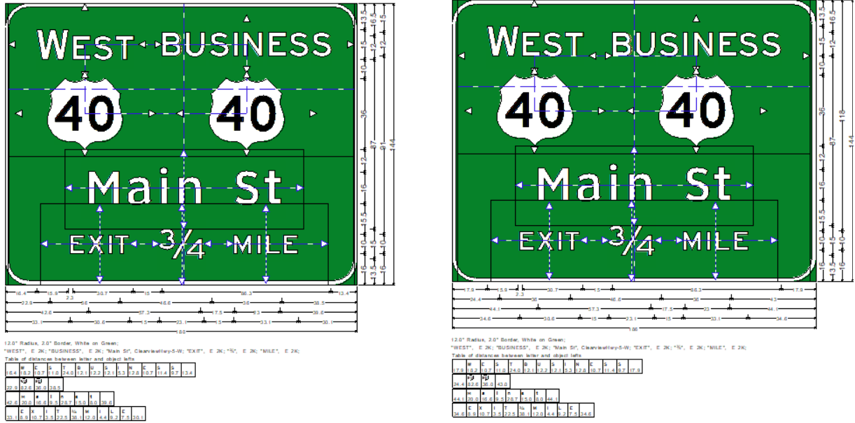

How do I change the row alignment on a tabular arrangement in OpenRoads SignCAD to bottom align text?

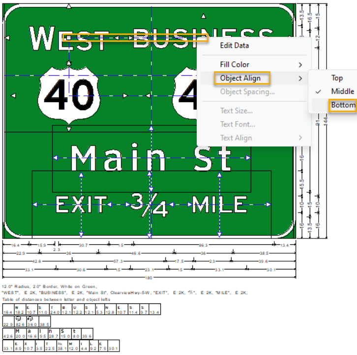

1) Pick the Arrange tool.
2) Right click on the arrangement line (dashed horizontal blue line inside the yellow rectangle) and pick Object Align>Bottom.
3) Pick the Select tool or another tool to turn off the arrangement lines. Save the file (File>Save).
