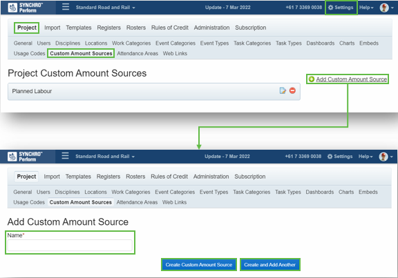

Create
- Click on Settings > Project > Custom Amount Sources.
- To add a Custom Amount Source, click Add Custom Amount Source.
- Add Name of Custom Amount Source.
- Click Create Custom Amount Source or Create and Add Another.

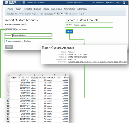

Import
- Click on Settings > Import > Custom Amounts.
- To export the Custom Amount file, under Export Custom Amounts select the Custom Amount from the Source drop down list and click Export.
- Click on the Download link.
- Edit the Custom Amount file data, as needed.
- To import the Custom Amount, under Import Custom Amounts select Choose file and select the Source from the drop-down.
- To add additional information or update existing information select Append/Update.
- To remove the existing information and add completely new information select Replace.
- Click Upload to import the file.
