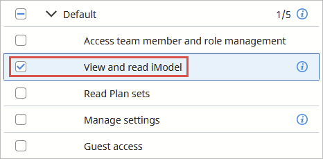

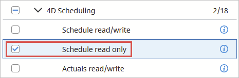

A user's role must have the following permissions selected -
Access > Control
default > View and Read iModel
4D Scheduling > Schedule (Minimum "Schedule read only" permission)

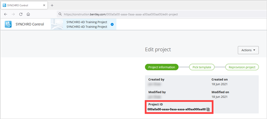

  1. To connect to a Bentley Infrastructure Cloud project you will need the Project ID available from the Bentley Infrastructure Cloud project Administration tab > Manage project details. In the gray box, Project ID is listed with a copy button next to the ID or from the project URL -

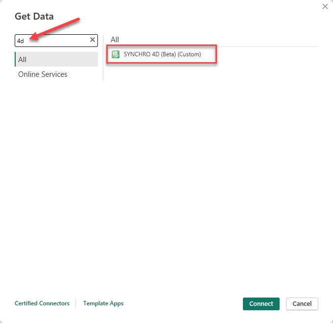

  2. Open Power BI Desktop and click on Get Data.
  3. Search for 4D in the top left corner search bar, or available through the Online Services sub-menu. Select the SYNCHRO 4D Connector.

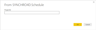

  4. Fill in the required ProjectId and click OK.

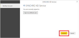

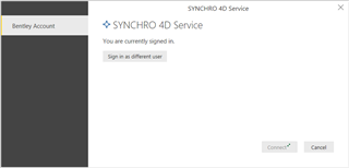

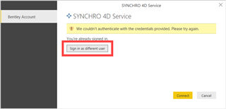

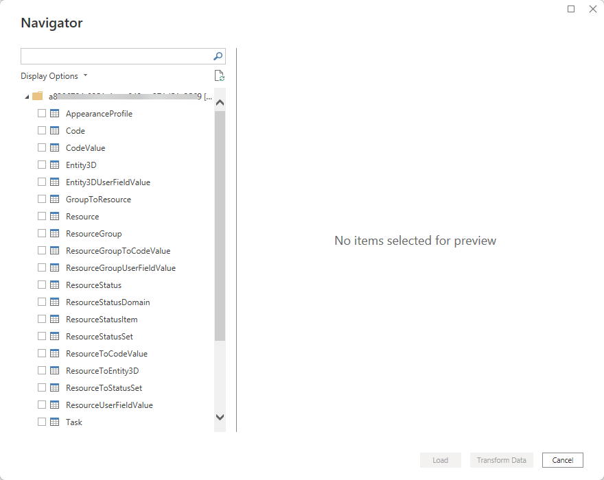

  5. Click on Sign in as a different user if you are not already signed in and enter your Bentley IMS login details -
  6. Upon signing in, click on Connect button -
  7. Once the connection is made, you will be able to view and select the tables to download -

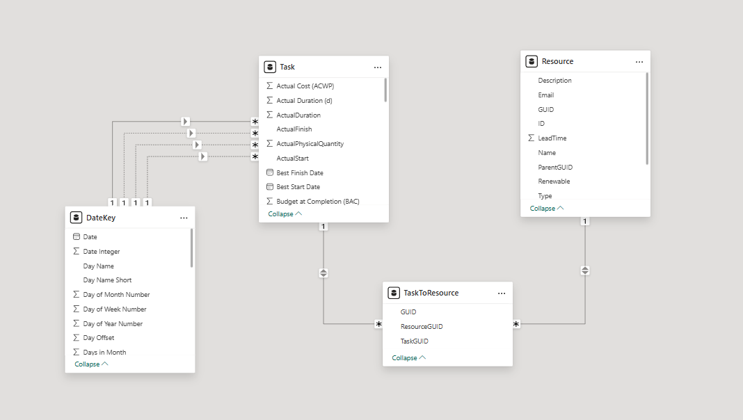

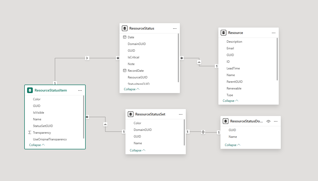

Table Relationships

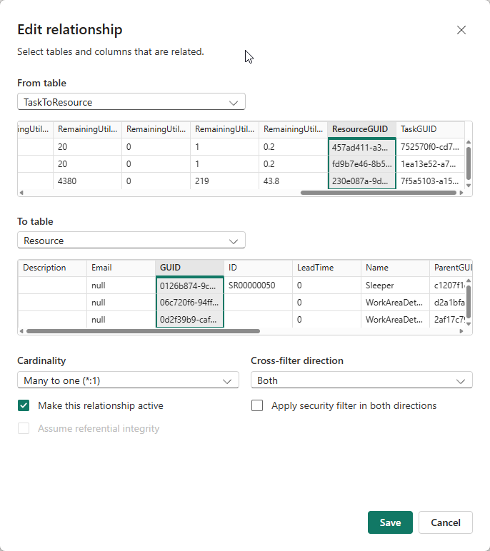

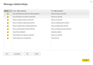

In order to cross-reference data between the tables, you will need to create relationships between them, primarily connecting GUIDs from relevant tables.
You can do so by going to Modeling ribbon > Manage relationships -
This is an example of what the the tables should look like -
Most relationships will have the Cardinality automatically set, but change the Cross filter direction to Both -

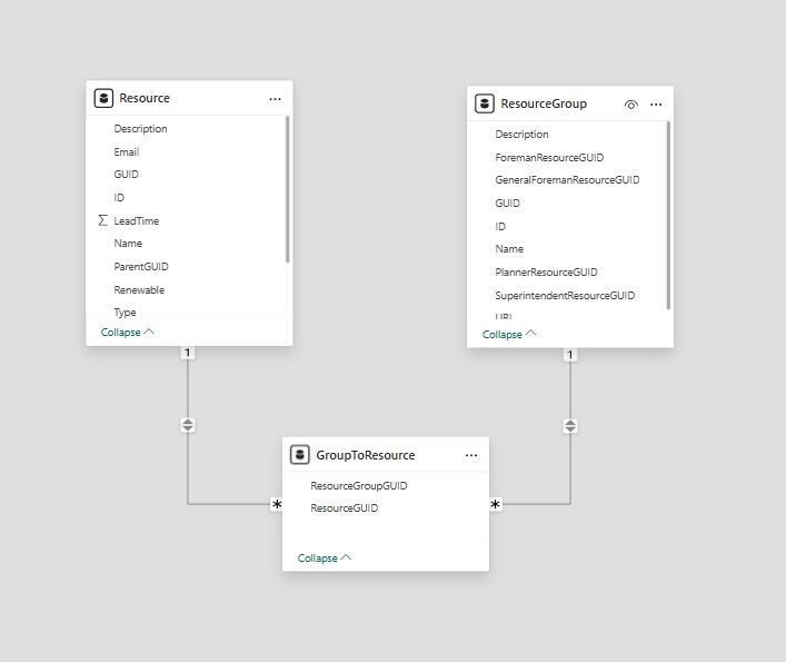

You can also use the Model tab to graphically create/review these relationships.
Task and Resource relationships
Resource and Resource Group relationships
Resource and Resource Status relationships

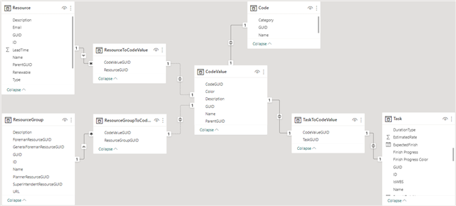

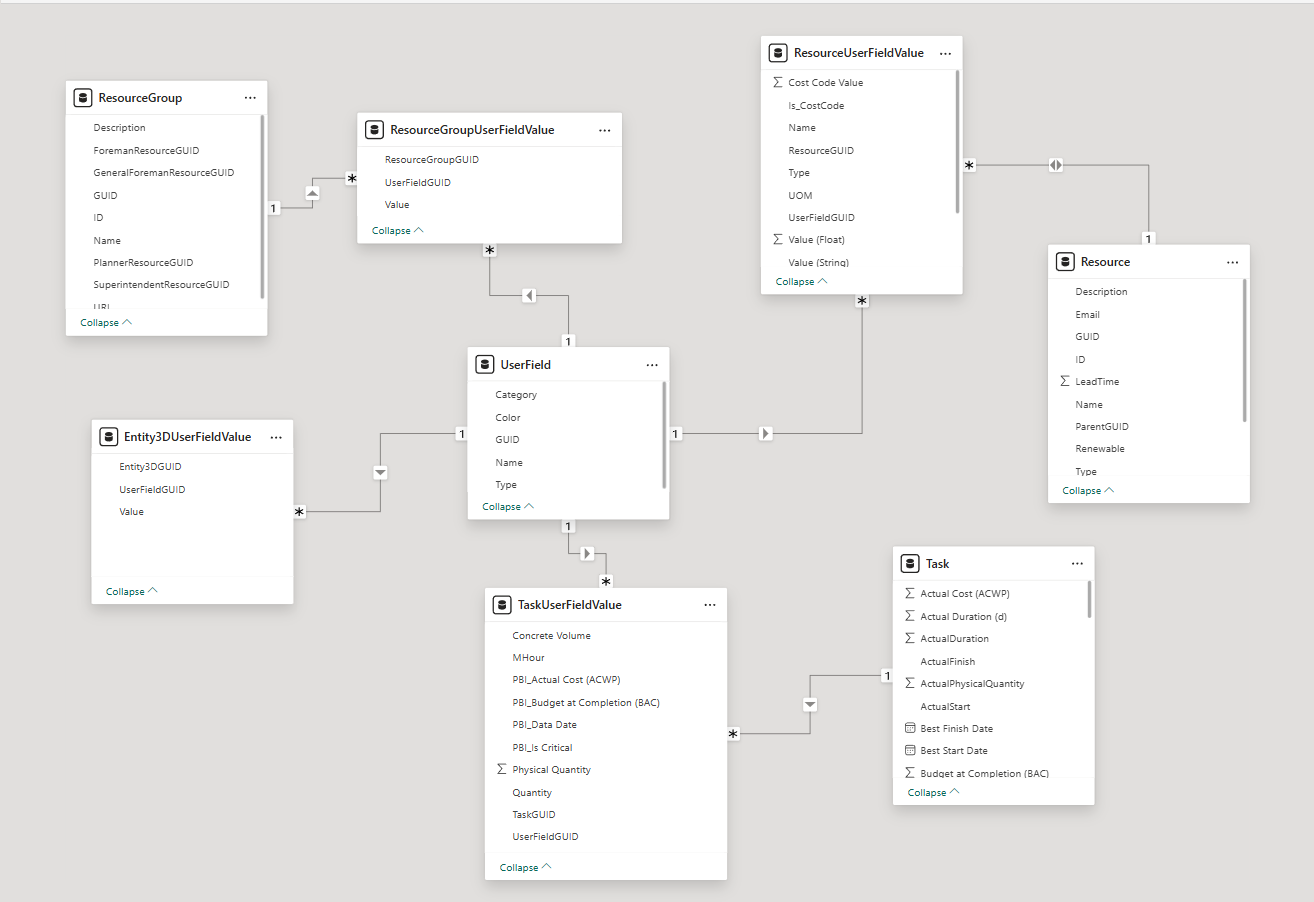

User Field relationships
Codes relationships

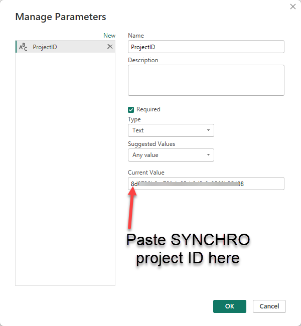

It is possible to set an existing Power BI report as a template, which can be reused with data from any other Bentley Infrastructure Cloud project, by creating an editable Parameter.

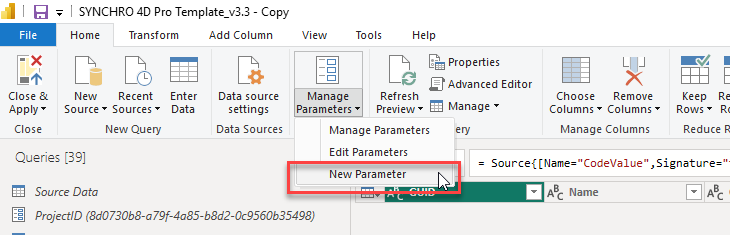

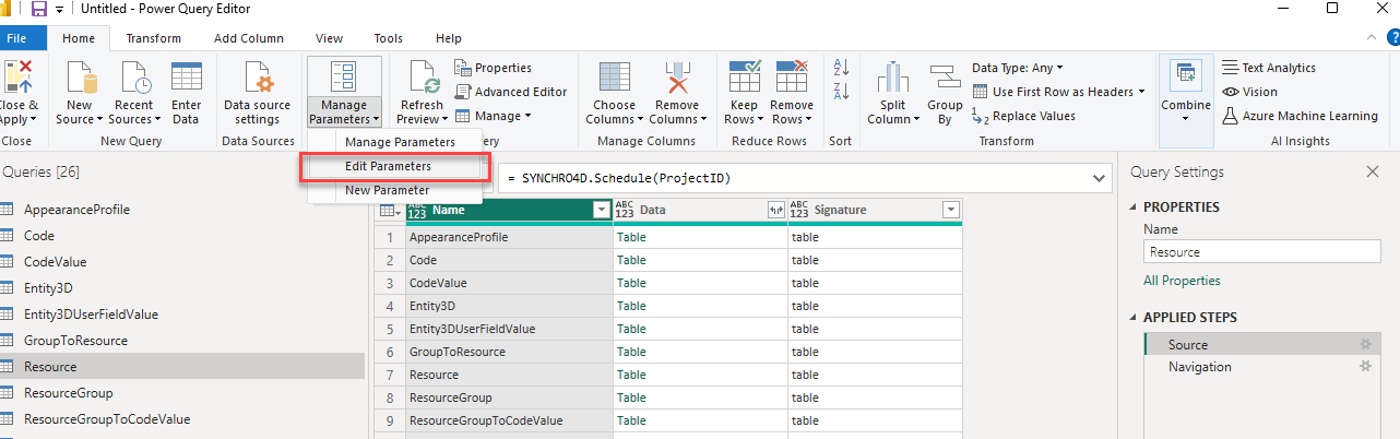

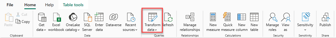

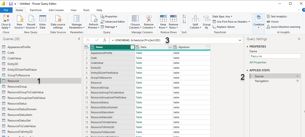

Go to Transform data to open Query Editor -
Go to Home ribbon > Manage Parameters > New Parameter -

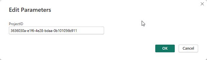

Create ProjectID parameter as below -
Replace the GUID with ProjectID for all the tables in Query Editor, then click Close & Apply -
Now you can update the ProjectID with any other SYNCHRO Bentley Infrastructure Cloud GUID to update the data on existing visuals and reports.
