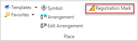

  1. Select the Registration Mark Tool: In the SignCAD interface, select the Registration Mark tool from the toolbar.

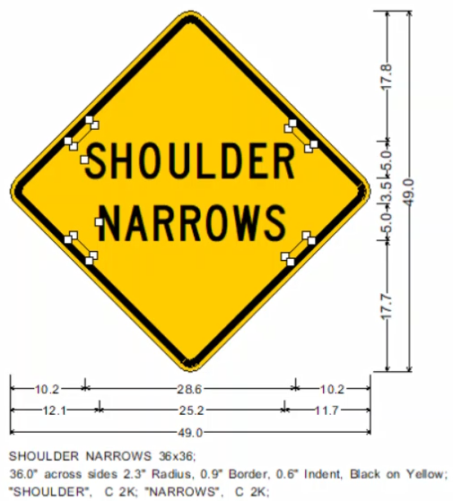

  3. Place the Mark: Click on the desired location to place the 1" x 4" mark. The mark will appear on the sign element as a guide during fabrication and construction.

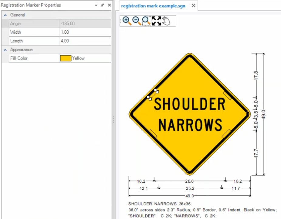

  4. Move the Mark: The registration mark can be moved by dragging it to a new location. The mark will snap to the original edge. Note that the mark cannot be rotated.
  5. Change Dimensions: The dimensions of the registration mark can be changed in the element properties.
