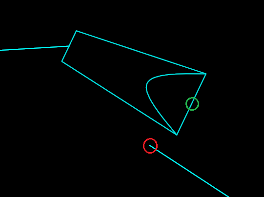

The amount of the discrepancy depends on:
If the connection region is at the opposite end of the endwall to the location point, then the discrepancy will be noticeable. However, if the connection region is in the same position as the location point, then you may not notice any discrepancy.
Issue #2 - Picking a Node or its Connection Graphics
This issue involves picking a connection graphic for a node where the position of a connected conduit may not update correctly
**Both Issues have been fixed in the 2024 versions of the OpenCivil Products**
The video below discusses both issues in detail. The video describes their effect and potential workarounds for each.
