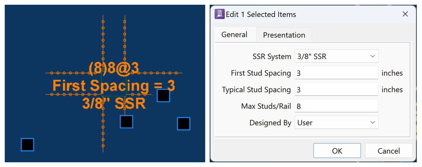

User Defined Shear Stud Reinforcement (SSR)
Program SSR can now be changed to User SSR. After conversion to User SSR, the following properties can be modified by the user:  SSR System, First Stud Spacing, Typical Stud Spacing, Max Studs/Rail.
During subsequent design calculations, only a final design check is completed at punching checks with User SSR. Additional program rails are never added to User SSR to achieve the required capacity. If the punching shear demand exceeds the reinforced punching shear capacity considering the User SSR, a design failure is indicated for the punching check.
Figure 1 - User SSR Group and Property Dialog

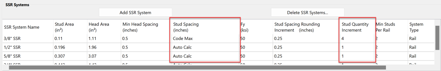

SSR System Material Properties
The following changes have been made to SSR Systems defined in the Material Specification table (Criteria > Materials) for the purpose of limiting the variation of Program SSR designs for a given floor:
Added Code Max and Auto Calc options for Stud Spacing property.
When the Code Max option is selected, RAM Concept fixes the stud spacing to the maximum spacing permitted by the selected design code and adds additional rails during SSR design to achieve the required strength. This option forces RAM Concept to minimize the number of different Program SSR designs across the floor.
When the Auto Calc option is selected, RAM Concept reduces stud spacing during SSR design to achieve the required strength. The Auto Calc option is identical to the None selection that was available in previous versions. This option may force RAM Concept to generate Program SSR designs with many different stud spacings across the floor.
The Code Max option is the default selected in new models.
Added Stud Quantity Increment property
The Stud Quantity Increment property specifies an increment for the number of studs that RAM Concept designs on any rail. Specifying a larger number for this property forces RAM Concept to minimize the number of different rail lengths specified across the floor.
This property is automatically set to 4 in new models and 1 for models that were created in previous versions.
Figure 2 - New SSR System Material Properties and Options
