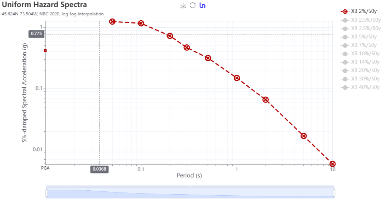

New Canadian Seismic Solutions to NBC 2020
The NBC 2020, Division B Part 4, Structural Design, 4.1.8 Earthquake Load and Effects, requirements for defining both the static seismic and response spectrum loadings are now available for both methods.
The response spectrum control has been designed to determine the base shear and forces from the spectral accelerations defined at the periods typically obtained from 2020 National Building Code of Canada Seismic Hazard Tool for a given site location and site designation.

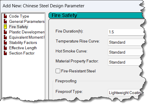

Chinese Fire Resistance Design
The solution offered for checking steelwork to the GB51249-2017, Code for Fire Safety of Steel Structures in Buildings, as a technical preview in the initial STAAD.Pro 2025 is now included as fully commercial offering.
This specifies the requirements for accounting for the changes in structural behaviour in different fire events which will degrade the properties of steel.
The requirements are created as an additional set of design parameters, much like the method used to define parameters for the hot or cold steel member design to GB50017 or GB50018.

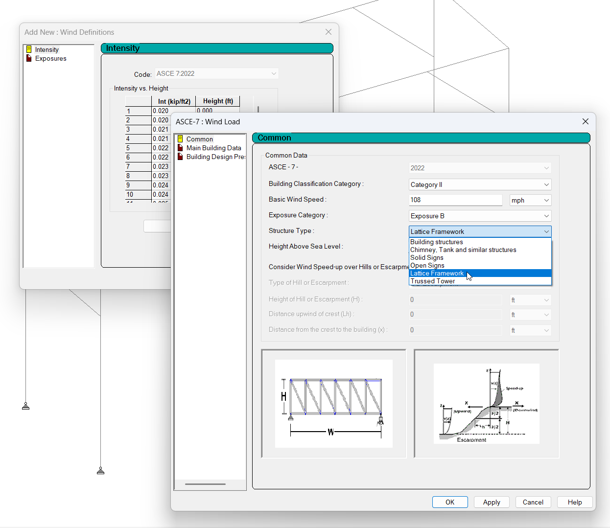

Wind Loading – US, ASCE 7, 2022
This release expands on the solution introduced in the STAAD.Pro 2025 major release with the additional support for structure types other than just building.
This wind solution now supports Chimneys, Tanks, Solid Signs, Open Signs, Lattice Framework and Trussed Towers.

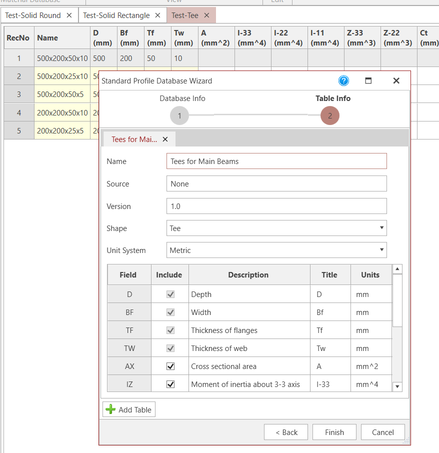

Extended Standard Profile Database Schema
The recent implementation of the new standard database schema which provided direct support for the shapes of wide flange, channel, angle, circular and rectangular hollow, as well as cold formed shapes channel, angle, hat and zee, has been extended to additionally support tee, solid round and solid rectangle shapes.
This means you can now create specific databases for use with projects for which having a limited pallet of shapes can be beneficial. Consider a concrete project where the requirement is for the team to use specific sizes. By providing them in a defined database you can ensure better alignment with the project requirements.

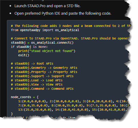

Python Package for OpenSTAAD
With continued growth in the use of the OpenSTAAD API by designers to assist in automation processes, additional capabilities have been added.
The most significant development is the inclusion of a dedicated Python package for OpenSTAAD. This means that, after installing the OpenSTAADpy package,  all the main OpenSTAAD functions can be called directly from a Python project
A screenshot of a computer programAI-generated content may be incorrect.
Note that there is a separate help document that covers OpenSTAADpy that can be accessed from the main Help backstage panel.

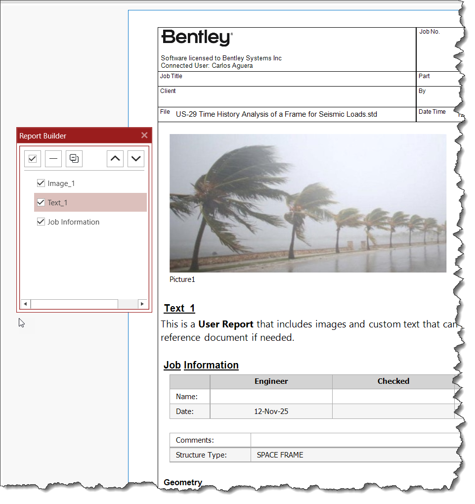

Two significant updates have been introduced to assist in producing customised reports from a STAAD.Pro model.

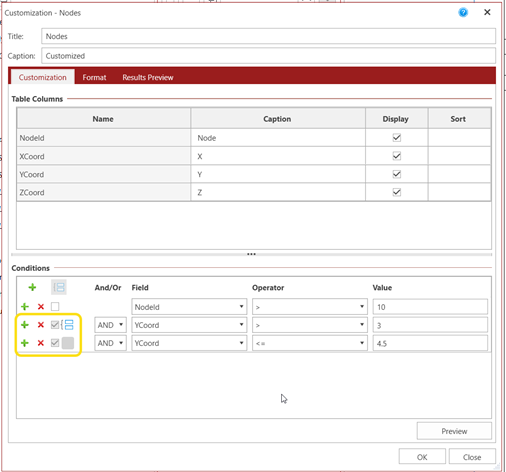

Firstly, User Reports have been enhanced to provide engineers with the ability to add both external images and text into a report without having to export the report into Word. More informative and professional level reports can be made quicker and within a more controlled environment.
Additionally when it comes to creating a detailed report and customisation is called for, a method is now provided to allow complex conditions to be defined by grouping together different rules rather than simply following each rule in turn.

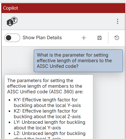

Documentation Copilot
Due to the size and quantity of the STAAD documentation, it can sometimes be hard to quickly identify the answers to questions that you might have that would help you get the most out of the program. To help address this issue, we have developed a virtual assistant that uses an AI process to help get you answers to questions such as ‘How do I create a wind load?’ or ‘What is the parameter for setting effective length of members to the AISC Unified code?’
This is being initially rolled out as an Early Access feature to obtain feedback from engineers on the service before it is rolled out more widely. To activate this service, simply click on the Copilot icon on any ribbon tab accept the details outlined provide in the program.

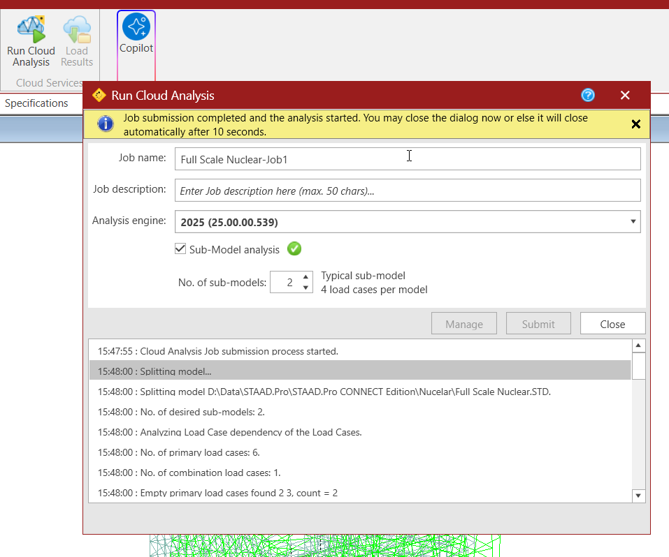

Cloud Analysis
This is a continuation of the offering provided in the STAAD.Pro major release, but has been enhanced following feedback so that with this version, the accelerated analysis solution offered using sub-models, can now include both static seismic and dynamic load cases. When identified in primary load cases, they will be aggregated into the first sub model along with any combinations that refer to them and the remaining load case cases will be sub divided into the additional models that will be solved in parallel.

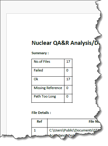

QA&R
This release has been delivered to meet the necessary requirements such that it can be used as part of the QA&R program. This means the STAAD nuclear QA license will activate the Analysis and Design Engine Testing tool in the backstage, the output of which can now be exported as a PDF document allow for creating permanent records.
