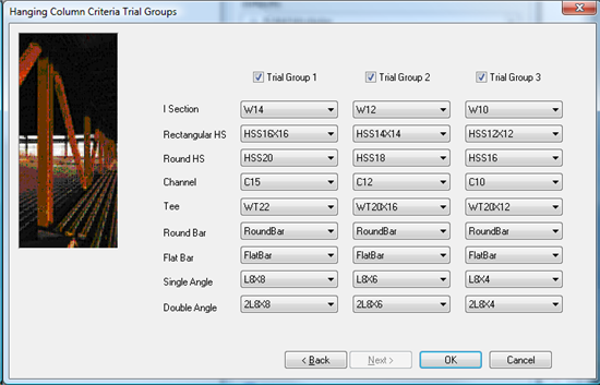

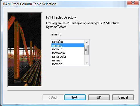

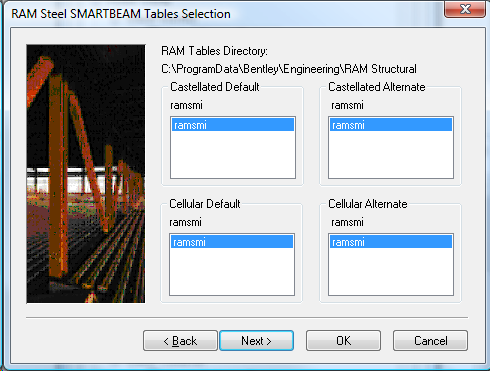

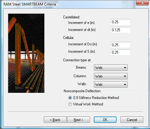

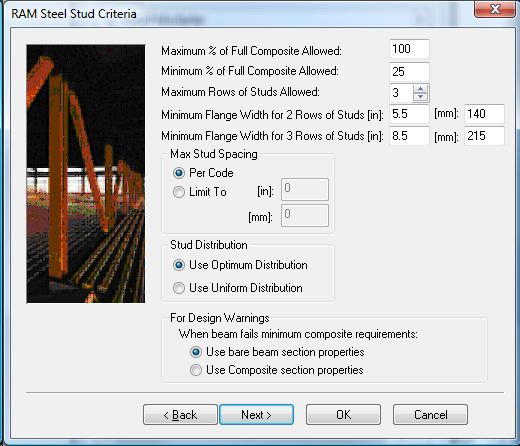

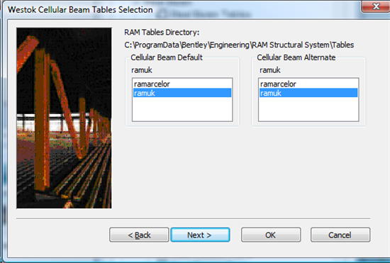

RAM Steel Defaults [TN]
 Product(s):RAM Structural System
 Version(s):v8i
 Environment: N/A
 Area: N/A
 Subarea: N/A

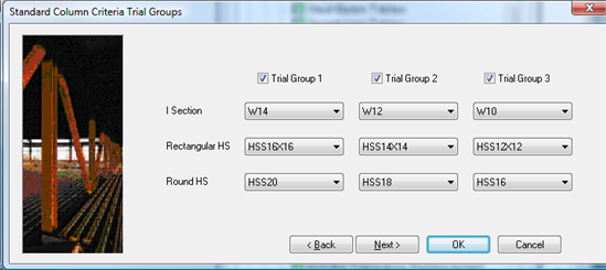

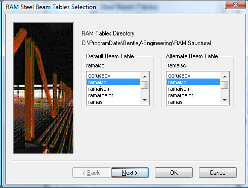

Steel Beam
Steel Column
