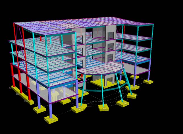

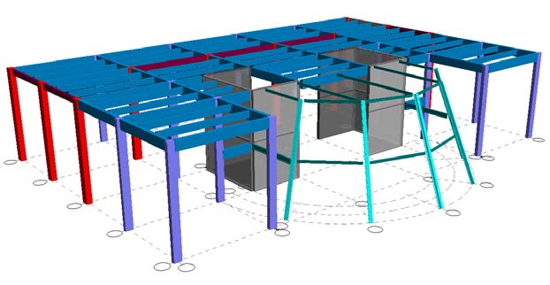

During this section of the tutorial, you will construct a 4 story building with a variety of member types and configurations. You will start by creating the 2nd Floor Plan as shown below. Then you will copy and edit that data to create additional floors. The model is intended to show many of the capabilities of the software all in this one model and as such may be somewhat eclectic.
To invoke the RAM Modeler, from the RAM Manager Menu Bar,
- Select Model (or click the Square button labeled Model in the upper left corner).

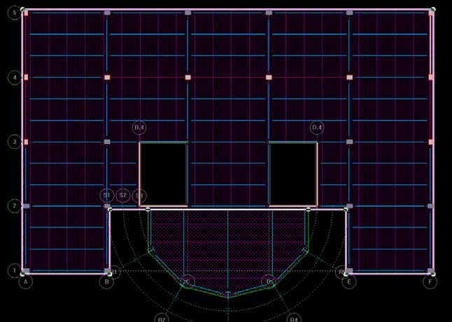

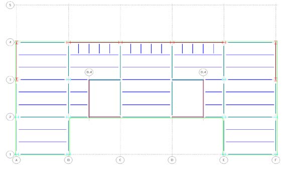

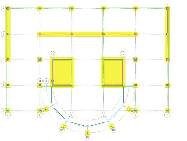

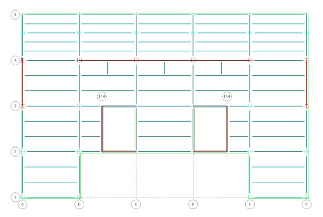

The 3rd floor of the tutorial model is depicted below for your reference. Refer to it when the written instructions are not clear.
Figure 1: 3rd Floor Plan Figure

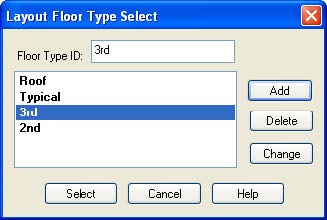

To create and select a floor type:
- Select Layout - Type - Select.
- Type 2nd for Floor Type ID and Click [Add].
- Type 3rd for Floor Type ID and click [Add].
- Type Typical for Floor Type ID and Click [Add].
- Type Roof for Floor Type ID Click [Add].
- Highlight 2nd and Click [Select].

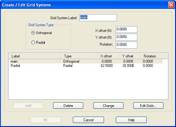

First, create the Grid Systems:
- Select Layout - Grids - Create / Edit.
- Type Main for Grid System Label.
- Set Grid System Type to Orthogonal.
- X and Y offset and Rotation should all be set to 0.
- Click [Add].
- Type Radial for Grid System Label.
- Set Grid System Type to Radial.
- Type 62.5 (20) for X offset.
- Type 20 (6) for Y offset.
- Type 0 for Rotation.
- Click [Add].

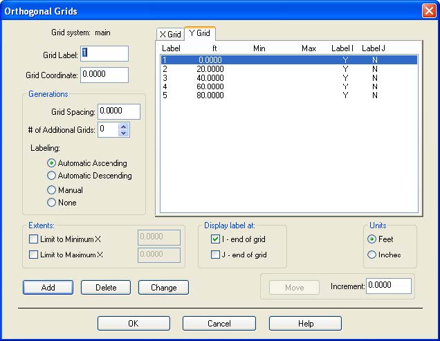

Select the Y Grid tab.
Figure 3
- Type 1 for Grid Label.
- Type 0 for Grid Coordinate.
- Type 20 (6) in the Grid Spacing field.
- Set the # of Additional Grids to 4 and set the Labeling to Automatic.
- Click [Add]. The program should generate grids 1, 2, 3, 4 and 5 at once.
Your screen should now have the grids shown in Figure 3 above.

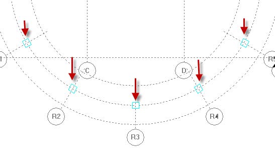

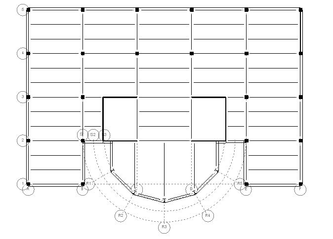

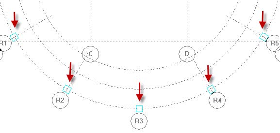

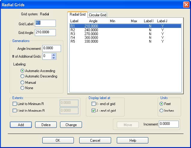

You will now define the grids for the Radial Grid System.
- Highlight Radial from the main list box.
- Click [Edit Grids]. The Radial Grids dialog box will open.
- Type R1 for Grid Label.
- Type 210 for Grid Angle and click [Add].
- Type R2 for Grid Label.
- Type 240 for Grid Angle and click [Add].
- Type R3 for Grid Label.
- Type 270 for Grid Angle and click [Add].
- Type R4 for Grid Label.
- Type 300 for Grid Angle and click [Add].
- Type R5 for Grid Label.
- Type 330 for Grid Angle and click [Add].

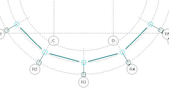

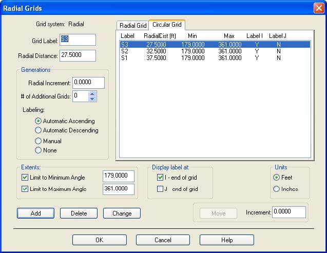

Select the Circular Grid tab.
- Type S1 for Grid Label.
- Type 37.5 (12) for Radial Distance.
- Check the Limit to Minimum angle and type 181 for the angle.
- Set the Limit to Maximum Angle at 359 and click [Add].
- Type S2 for Grid Label.
- Type 32.5 (10.5) for Radial Distance.
- Type S3 for Grid Label.
- Type 27.5 (9) for Radial Distance.
- Click [OK] to go back to the Create / Edit Grid Systems Dialog box.
- Click [OK] to finish the grid creation. If you made any mistakes, you can reopen the grids control and change the coordinates or other property of the grids. Just select the grid first, make the desired changes and click [Change].

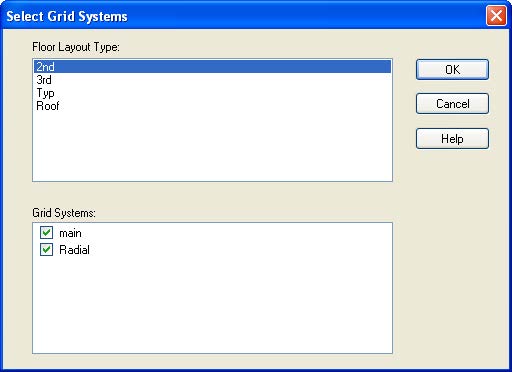

To select the grid systems to be used for the various levels:
- Select Layout - Grids - Select. The Select Grid Systems dialog box should appear:
- Highlight 2nd under Layout Floor Type if it is not already.
- Check both Main and Radial boxes under Grid Systems.
- Click [OK].

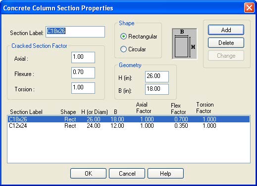

- Select PropTable - Column Sections and the Concrete Column Sections Dialog will appear.
There are two concrete column sizes required for this model:
- Type C18x26 (C45x66) for Section Label.
- Enter 26 (660) for H.
- Enter 18 (450) for B.
- Click [Add].
- Type C12x24 (C30x60) for Section Label.
- Change the Cracked Section Factor for Flexure from 0.70 to 0.35. 0.7 is the default value for columns, but the C12x24 columns will be used like pilasters at the ends of a wall.
- Enter 24 (600) for H.
- Enter 12 (300) for B.\
- Click [Add].
- Click [OK].

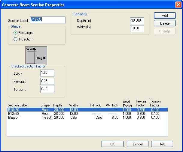

To enter the concrete beam properties:
- Select PropTable - Beam Sections. The Concrete Beam Sections Dialog will open.
There will be three different concrete beam sections in this model. Enter them as follows:
- Enter B12x28 (B30x66) for Section Label.
- Set the Shape option to Rectangular.
- Enter 28 (660) for the Depth and 12 (300) for the Width
- Click [Add].
- Enter B18x30 (B45x75) for Section Label.
- Enter 30 (750) for the Depth and 18 (450) for the Width
- Click [Add].

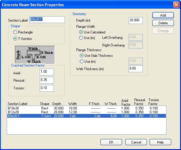

- Enter B8x20-T (B20x50-T) for Section Label.
- Set the Shape option to T-Section.
- Type 20 (500) for Depth.
- Set the Flange Width to Use Calculated (the program will determine the individual beam widths based on the span, the distance to a slab edge or the distance to an adjacent beam, whichever controls).
- Set the Flange Thickness to Use Slab Thickness.
- Set the Web Thickness to 8 (200).
Note: The program does not count any tapering of the T beam stem. - Click [Add] and click [OK].

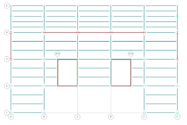

Concrete Column Layout
Columns can be located at the intersections of gridlines (On-Grid) or at any other location on the layout (Off-Grid). Throughout the program output, columns are identified by the grid intersection they are on, so it is recommended to place the column On-Grid. Placing columns On-Grid is also the best way to assure that they line up from level to level. If a column is at the confluence of three or more grid lines, you may want to stop all but two of the grid lines short of the intersection so that the program can identify the column correctly.

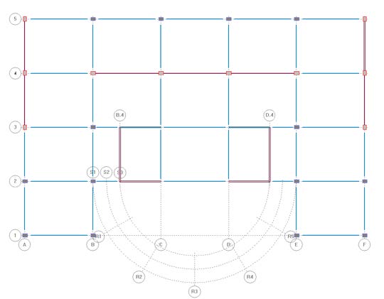

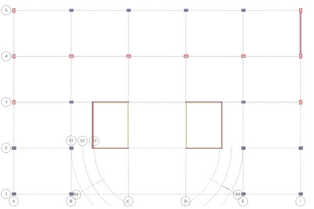

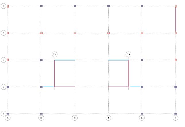

Figure 4: Concrete Column and Wall layout (2nd Floor Type)

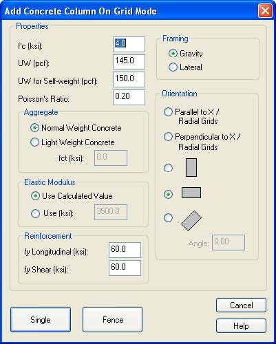

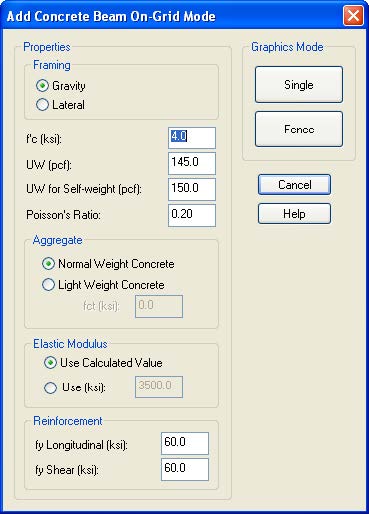

To begin modeling the columns:
- Select Layout - Columns - Add On-Grid. The Add Concrete Column On-Grid Mode dialog box should appear.
- Enter 4 for f'c (30 for fcu).
- Enter 145 (2350) for Unit Weight
- Enter 150 (2400) for Unit Weight for Self-Weight
- Enter 0.20 for Poisson's Ratio
- Select Normal Weight Concrete
- Select Use Calculated Value for Elastic Modulus
- For Reinforcement, enter 60 (410) for fy Longitudinal and 60 (410) for fy Shear
- Set Framing to Gravity.
- Set Orientation to
(this is zero degree orientation). - Click [Single].
This will take you back to the graphics screen with the plus sign cursor
- With the cursor, place a column (Left Click one time) at these grid intersections:
A-1, A-2,
B-1, B-2, B-3, B-5,
C-5,
D-5,
E-1, E-2, E-3, E-5,
F-1, and F-2. - Right Click with the mouse to return to the Add Concrete Column On-Grid Mode dialog box (right clicking in the Modeler always returns you to the previous dialog box):
- Change Framing from Gravity to Lateral.
- Click [Single] to return to the graphics screen:
- Place lateral columns by clicking at Grids
B-4, C-4, D-4 and E-4. - Right Click to return to the Add Concrete Column On-Grid Mode dialog box.
- Change Orientation to
(90 degrees). - Click [Single] to return to the graphics window.
- Place 3 lateral columns on the remaining grid intersections for grid lines A and F.
Note: If you accidentally place a member with an incorrect setting, you can undo the last command Using Edit - Undo. If it's too late to undo the command, then you can delete the erroneous column and model it again, or you can fix it by using the Change Properties command. This is covered later in the tutorial.
Now assign concrete column section sizes.
- Select the Layout - Columns - Assign Size Command. The Assign Concrete Column Size Mode dialog box will appear.
- Select C18x26 (C45x66) from the list box and click [Fence]. This will take you back to the graphics screen:
- With the cursor drag a window large just enough to encompass all of the columns. Window selections in the modeler only work on items entirely within the window.
- Right click to return to the Assign Size command.
- Select the C12x24 (C30x60) from the list and click [Single].
- This time select only the gravity (blue) columns. This will override the previous assignment.
This completes the layout of concrete columns on the 2nd Floor. We have a few steel columns to add, but we are going to put the concrete walls in first.
Concrete Wall Layout
Like columns, walls can be placed on or off of the established grids. You will only use the On-Grid feature in this section. Walls can only be placed while the current material is set to either "Concrete" or "Other".

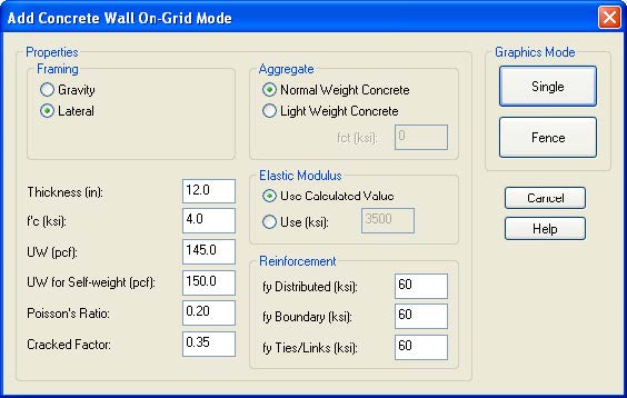

- Select Layout - Walls - Add On-Grid. The Add Concrete Wall On-Grid Mode dialog box will open:
- Set Framing to Lateral.
- Type 12 (300) for Thickness
- Type 4 for f'c (30 for fcu).
- Type 145 (2350) for UW (this is used to calculate E).
- Type 150 (2400) for UW for Self - Weight (this is only used if the RAM Manager self weight criteria has walls selected)
- Type 0.2 for Poisson's Ratio
- Type 0.35 for Cracked Factor
- Leave the other fields as their defaults
- Click [Single]
- With the cursor, place a wall by clicking once at the beginning and once at the end of the wall.
Note: In single mode, a white line appears after selecting the start point of a wall. This "rubber band" displays the position of the wall before the other end is located. The same graphic also appears when laying out slab edges, deck polygons, line loads, etc.
- Start by clicking at grid F-4
- Move the cursor to grid F-5.
- Once there, click to complete the wall layout.
- Add walls between the following grid intersections:
- From B.4-3 to B.4-2
- From B.4-2 to C-2
- From D-2 to D.4-2
- From D.4-2 to D.4-3
Note: In the modeler, walls and columns are placed according to the center location. In reality a concrete wall between two pilasters may be shifted slightly from the column centerline or gridline. For simplicity of modeling and analysis, it is highly recommended to place the columns and walls on the same centerline regardless.
- Right click to return to the Layout Walls dialog box.
- Change the framing from Lateral to Gravity.
- Click [Single] to return to the graphics mode and add two walls
- From B.4-3 to C-3
- From D-3 to D.4-3
- The screen should then look like Figure 4 above.

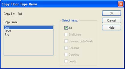

Copy Floor Types
In many buildings the various floor types are similar. The program has a feature for copying information from one level type to another. The feature only works when you have a blank level type current.
The graphics view is altered to show you the 3rd floor type. At this time, there is nothing on this floor type.
It is completely blank at this time. In the menu bar at the top of the modeler, you'll notice that the current level type has changed from 2nd to 3rd. This pull down menu is the quickest way to switch from level to level.
The 3rd level will now be an exact duplicate of the 2nd floor. Any changes made from this point on will be to one level only. We will copy to the Typical and Roof floor types later.
Concrete Beam Layout
Beams can either be located between the intersection of gridlines or existing members, or Off-Grid, which is usually the case for secondary framing. Beams can also be automatically generated by the program at regular spacing. Cantilevers can be added to beams after the main span is modeled. Not all beam layout commands will be illustrated in this tutorial, but all are explained in the on-line Help or RAM Modeler documentation.
Figure 5: Concrete Beam Layout (3rd Floor)
Since there are only 2 concrete beams to be added to the 2nd floor type, we will quickly add them then move to the 3rd floor type for a detailed approach to adding beams. To add beams to the plan:
Note: You can also change floor types by selecting 2nd from the drop down combo box on the toolbar:
Select
Layout - Beams - Add On-Grid. The Add Concrete Beam On-Grid Mode dialog box should appear.
Type 4 (30) for f'c.
Type 145 (2350) for UW.
Type 150 (2400) for UW for Self-Weight.
Click [Single].
- These beams will be added in the same way the walls were added; by clicking on a grid intersection, moving the cursor to a second grid intersection and clicking to complete the member.
- With the mouse select the column on Grid B-2.
- Move the cursor to the concrete wall end at C-2, and left click the mouse to finish.
- Repeat to add a beam between the wall at D.4-2 and the column at E-2.
- This completes the 2nd floor type framing. At this point, please verify that the model is identical to the following figure for the 2nd level floor type:
Figure 6: 2nd floor type Concrete Beam layout
Now switch to the 3rd floor type to continue laying out concrete beams.
Switch to the 3rd floor type by selecting Layout-Type-Select and selecting 3rd or by using the drop down combo box on the toolbar as shown previously.
Right click to return to the Add Beam On-Grid dialog box.
Click [Fence] to return to the graphics window.
Create a large enough box to encompass the entire floor plan.
A word about the Fence option: this will add beams from column to column (on grid) within the fenced area. If you incorrectly add a beam, it can be deleted or you can undo the last steps. Fence mode is extremely useful for adding beams in regular structures.
For this model, the fence command added a beam between grids B-1 and E-1 that is not needed. To remove it:
- Delete the long beam that was created between B-1 and E-1 by selecting Layout-Beams-Delete and selecting [Single].
Note: You can also delete the currently selected member type by using the delete button on the toolbar.
Add additional beams as follows.
- Return to the Layout beams on grid dialog window, and select [Single] to return the graphics window.
- Connect all of the columns together with beams and connect the ends of the walls to columns with gravity concrete beams.
Now change the gravity beams between lateral columns to lateral beams selecting Layout-Beams-Change Properties, then selecting the Framing checkbox (which will activate the Framing dialog) and the framing to lateral. The final Framing plan should look like this:
Figure 7: Concrete Beams On-Grid (3rd Floor Type)

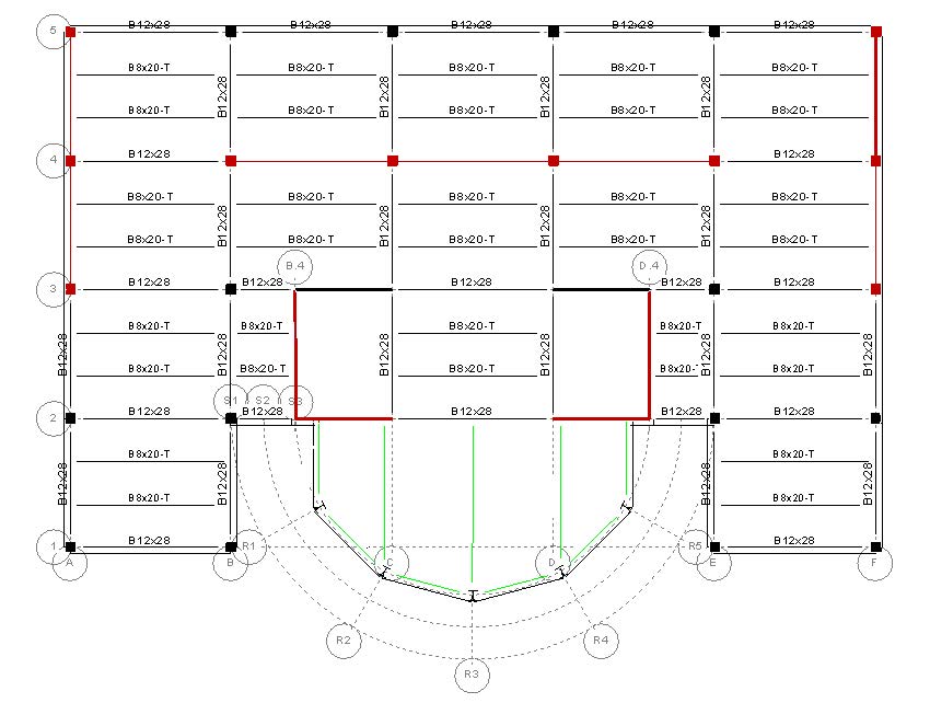

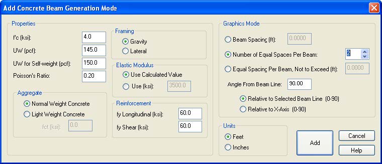

Now it's time to add the infill beams. These beams could be modeled as either beams or pan joists. When adding pan joists, you must initially assign a size to the edge beams, then specify the pan size or the spacing between the beams. If the spacing does not work out perfectly, then there will be one odd space. When laying out beams, on the other hand, it is the centerline that you are defining. Since this tutorial needs to work for two systems of units, we will add beams rather than pan joists. To add the intermediate, infill beams:
Select
Layout - Beams - Add Generation. The following dialog box will appear:
Change the number of Equal Spaces per beam from 2 to 3.
Click [Add] to return to the graphics window.
Click once at the column on Grid A-1 where the generation will start from. Then click a Second time at Grid A-5 to terminate the string of beams.
A direction line appears at the center of the line just drawn to indicate the orientation of the beams about to be generated. Click to the East side of line A to project the new beams in that direction.
Notice the command line at the bottom of your screen. The brief instructions typically lead you through the layout steps
Repeat the steps above for all open spaces between framing in the same E-W direction except between concrete walls as shown in Figure 5 above.

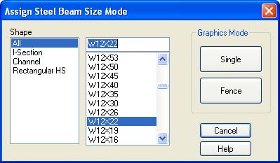

Like concrete columns, all concrete beams must be assigned a preliminary size in order to perform a complete analysis. Before assigning sizes, it's best to turn on the size display:
- Select Options - Show Sizes (you won't see anything different).
- Select Layout - Beam - Assign Size.
- In the Assign Size dialog box, highlight the B8x20-T section (B20x50-T) and click [Fence].
- In the graphics mode, fence the entire floor plan.
- Right click to return to the previous window.
- Highlight the B18x30 (B45x75) section and click [Single].
- With the target cursor, select each of the Lateral Girders.
- Highlight the B12x28 (B30x66) section and click [Single].
- Pick each of the gravity framing beams on Grids A through F and 1 through 5.

Steel Column Layout — Lower Levels
Modeling Steel members is identical to modeling concrete members, but the gravity only steel members do not have to be assigned any specific size. The RAM Steel design modules will select an optimum size for each.

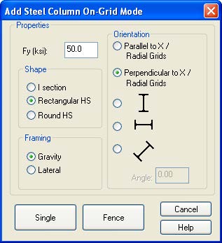

Now it's time to add the extra columns for the entrance atrium canopy on the 2nd and 3rd level:
- Select the 2nd floor type.
- Select Layout - Columns - On-Grid.
- Set the Fy value to 50 (355).
- Change the shape to Rectangular HS
- Change the Framing type to gravity
- Change the orientation to "Perpendicular to X / Radial Grids.
- Click [Single].
- With the
cursor, add steel columns to the Radial Grids at R1 through R5 at S1.
2nd Level Steel Columns
Change to the 3rd floor type using the drop down list on the top menu bar.
Right click to resume adding columns.
Add the same steel columns to grids R1 through R5 and S2 on this level.
3rd Level Steel Columns
Moving and Sloping Columns

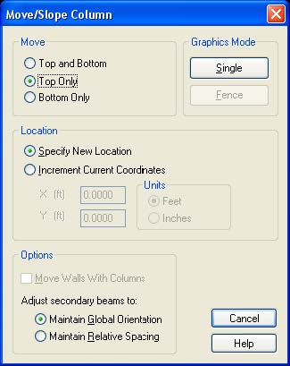

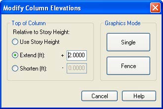

In the modeler you have the option to move columns either completely or top or bottom only. With the top or bottom only commands you can slope a column or join the top or bottom of multiple columns at a point. In order to achieve the sloping face of the open atrium we will have to slope the steel columns of the 2nd and 3rd floor types.
- Select the 2nd floor type by using the drop down menu in to toolbar.
- Select Layout-Columns-Move or by selecting the column icon in the toolbar and then the move icon to the right.
- In the dialog box select Top only and click [Single] (leave the location set to Specify New Location). This allows you to select the new location of the TOP of the column in the modeler.
- Select the column at grid intersection R1-S1 and notice that the column highlights. Move your cursor to the intersection of grid line R1-S2 and click to move the top of the column. Notice that there is a shadow of the column from the bottom location to the top.
- Repeat for all the columns along gridline S1.
- Switch to the 3rd floor type.
- Now slope the top of the steel columns on gridline S2 to gridline S3 in the same manner as the columns on the 2nd floor type.
Note: You can also move the complete columns or top or bottom only by using the Increment Current Coordinates command in the Column-Move dialog or in the Layout-Columns-Text dialog.
Note: For gravity columns, remember that RAM designs the columns for the vertical component of the forces only. All horizontal thrust data is not used or stored. So, for columns with increasing angles and lateral loads, the thrust that is resisted or transferred by these columns is neglected.
Steel Beam Layout — Lower Levels
Steel beams, like concrete beams, must be modeled to have two supports. Beams with cantilevers are modeled as simple-span beams first, then the cantilevers are added to the end. Do not attempt to add a long beam from the tip of the cantilever to the other end of the beam as it will cross the supporting beam or column which is not allowed. When you have indeterminate systems, like two cantilevers meeting at a point, simplifications may have to be made. To begin laying out beams:
- Select Layout - Beams - Add On-Grid.
- Change the shape to Channel
Note: In order for a beam to be designed as a composite beam, it not only needs to be defined as a composite section, but it also needs to have a composite deck on top of it for the entire beam length. If the beam is covered with noncomposite deck (or no deck at all) then it will always get designed as noncomposite.
- Click [Single].
- Add steel beams connecting the new steel columns together.
Note: The direction you add the beam does not matter. Beams are always assigned a left end and a right end based on the geometry.
2nd Floor Steel Beams On-Grid

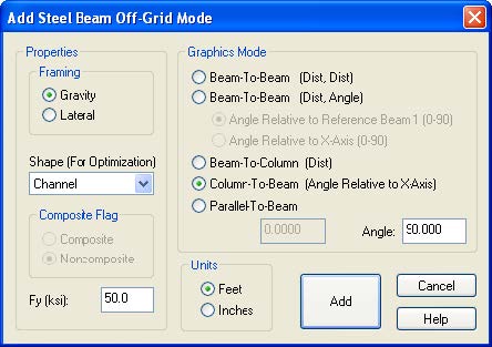

We need a pair of beams to finish the framing of the open atrium. To add them:
Select
Layout - Beams - Add Off-Grid.
There are many options for adding beams off-grid. Often it is a matter of adding a new beam parallel to an existing beam with some specified offset. This can be done even if the new beam is in a different bay. In this case the beams will be added from a column to a beam.
Set the Graphics mode to Column-To-Beam
Set the angle to 90. This will allow us to add new beams from a selected column to the closest beam that is 90 degrees (global) from the column.
Click [Add].
With the target cursor, select the column at R1-S2 and then click to the north of that column. Repeat for the column at R5-S2.
Repeat the above steps for all of the columns on grid line S3.
3-D view of first 2 floor types
That completes the layout of beams on the 2nd level, but there is some more work to do on the other level types.
Steel Member Layout — Typical Level
We'll start our work on the Typical Level, by copying all items from the 3rd floor type.
- Select the Typical level type.
- Copy the 3rd floor type to the typical level and select All items to copy.
We will not use the radial grids on this level so it is best to turn them off.
- Go to Layout-Grids-Select
- Uncheck the box beside Radial and click [OK].
Not all of the walls from the 3rd floor type are used on the Typical level so some need to be deleted.
- Be sure the selected material mode is Concrete. If it is not, change to Concrete now using either of the methods shown previously.
- Select Layout - Walls - Delete.
- Click [Single] and delete the wall on grid line F
We will now add a beam where the wall had been.
- Select Layout - Beams - Add on Grid.
- Add a beam where the wall had been as shown previously.
Note: At this time the beam is concrete, like the other members on the level.
The Typical floor is comprised of steel members but since we copied the framing from the 3rd floor, the members are currently all concrete. Change the material of the beams as follows:
- Select Layout - Beams - Change Material.
- Change Fy to 50 ksi (355).
- Change the Shape to I section.
- Set the framing to Composite.
- Click [Fence] and fence the whole floor to change all of the concrete beams into steel.
Now, clear all of the user assigned sizes (assigned to concrete beams prior to copy).
- Select Layout - Beams - Clear Size
- Click [Fence] and fence all of the beams on the Typical floor type.
Note: If the concrete sizes are not cleared from the steel beams, the Steel Beam Design Module will search for the user assigned sizes in the steel tables resulting in design errors.
Now change the columns from concrete to steel.
- Select Layout - Columns - Change Material.
- For the Fy value type 50 (355 for py).
- Set Shape to I section.
- Click [Fence] and in the graphics mode fence the entire framing.
All of the columns are changed into Steel Wide flange shapes. The framing and orientation of the original columns are maintained.
Now we must change the lateral steel columns on grid line 5 to gravity and change their orientation to
- Select Layout-Columns-Change properties and checking the Orientation and Framing boxes and making the appropriate changes.
- Click [Single]
- Click on the columns at the ends of grid line 5.
Similarly, change the beam on grid A between grids 4 and 5 to gravity.
Move the columns on Gridline 5 by
- Select Layout-Columns-Move.
- Select the Top and Bottom option under Move
- Select the Increment Current Coordinates option under Location.
- Enter -8 (-2.5) in the Y text box, leaving the X box at 0.
- Select Maintain Relative Spacing under options,
- Click [Fence] and fence all the columns on Gridline 5.

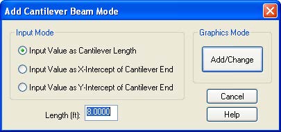

We will now add a cantilevered balcony to the Typical level.
- Select Layout-Beams-Add Cantilevers.
- Choose the Input Value as Cantilever Length option
- Enter 8 in the length box.
- Click [Add/Change].
- Select the girder on Grid A between grids 4 and 5. Click the north end of that girder to add the cantilever.
- Repeat for the same girders on grids B, C, D, E and F.
- Select Layout-Beams-Add Off Grid.
- Choose the Beam-To-Beam (Dist, Dist).
- Enter 0 for both distances
- Click [Add].
- Click on the end of the cantilever beam on Gridline B, then on the north side of the same beam.
- Next click on the cantilever on Grid Line C, and again on the north side. Notice the beam gets added to the ends of the cantilevered beams.
Note: You can also use the Add On Grid command for this situation as snap points are assigned to the ends of all beams.
- Repeat for all of the cantilevered beams.
- Right Click to return to the Layout-Beam-Off Grid dialog.
- Chose Beam-to-Beam (Dist,Angle),
- Enter 4 (1.25) for dist
- Enter 90 for Angle.
- Click on the end of the cantilevered beams and into the bays to add a floor beam in those bays.
Verify the typical level framing in the picture below.
Complete Framing of the Typical Level

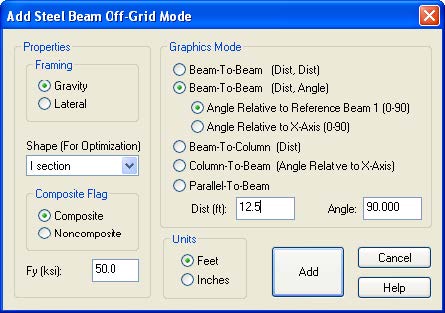

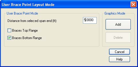

Now, we will place some lateral beam bracing for the moment frame beams.
- Select Layout Beams - Add Off-Grid.
- Select Gravity for the Framing
- Select Composite for the Composite Flag.
- Select the option Beam-To-Beam (Dist, Angle).
- Select Angle Relative the Reference Beam 1 (0-90) as your Beam-To-Beam option.
- Set the Dist. to 12.5 (4)
- Enter 90 degrees for the Angle.
- Click [Add].
- With the target cursor, select the lateral beam from grid B-4 to C-4.
- Click to the west end of that beam.
- A white horizontal line will appear 12.5' from the left end of that beam. Click to the south side and the new beam will be placed on that side. This beam will brace the top and bottom flange of the lateral beam which will improve the design.
- Repeat for the lateral beams on Grid 4.
Lateral Beam bracing

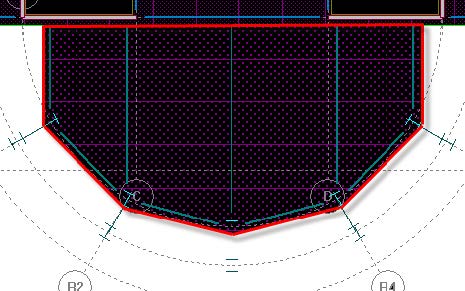

Slab Edge
Now that the floor framing layout is complete, the slab edges and slab openings must be laid out. Regardless what type of deck you are using, the level needs to have a slab edge. The deck and surface loads need the slab edges to define their boundaries. To layout the slab edge:
- Select the 2nd level type.
- Select Layout - Slab - Slab Edge.
- Type 12 (300) for Slab Overhang.
The slab edge overhang is measured from the beam centerline and must be at least 1". - Click [Add].
- Start at the column at A-1 and move clockwise to A-5, C-5, C-2, B-2, B-1, and close it at A-1.
Note: When "Left" is selected as shown above, always layout slab edges in a clockwise direction. Moving in the opposite direction will result in errors.
- Repeat the clockwise addition of the next diaphragm by starting and ending at D-5.
Press the <Esc> key to dismiss the "Keyboard Entry" dialog and return to the arrow cursor.
You should see the slab edge (a green outline) surrounding the entire perimeter of each of the two diaphragms on the 2nd Floor Plan. The slab edge must create a single, complete loop.

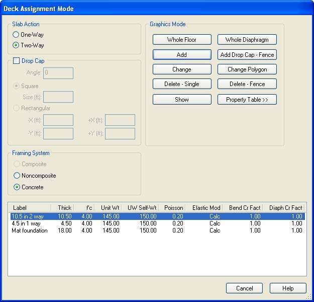

Floor Slabs and Deck
To complete the physical model it is necessary to apply a slab or deck to the structure. The slab and the deck properties are necessary both to determine composite beam section or T-Beam properties as well as to facilitate the distribution of the gravity load. You do this in two stages, first you will define the properties of the decks and slabs, and then you will layout the slab on the floor. To define the Slab Properties:

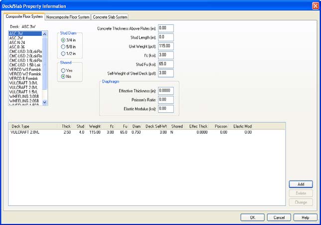

- Select PropTable - Decking.
On the Composite Floor System tab,
- Select VULCRAFT 2.0VL (Kingspan MD 60-V2) as the deck type.
Set the other attributes as follows:
- Concrete Thickness Above Flutes: 2.5 (65)
- Stud Length: 4 (100).
- Unit Weight: 115 (2400).
- f'c: 3 (fcu: 27.5).
- Stud Fu: 60 (450).
- Self-Weight of Steel Deck: 3 (0.15).
- Set the Stud Diam to 3/4 (19).
- Set the Shored option to No.
- Click [Add].

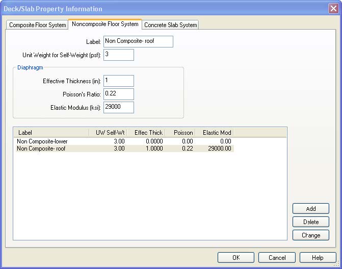

On the Noncomposite Floor System tab, define two noncomposite decks.
- Enter Non Composite-lower for Label
- Enter a deck Unit Weight for Self-Weight of 3 (0.15),
- Leave all other fields blank.
The program is not designing decks at this time, only using the deck self weight in the loads. It is up to the user to make sure the deck selected can span the required distances in the model. - Click [Add]
- Enter Non Composite -roof for Label.
- Enter 3(0.15) for the self weight again,
- Fill out the Diaphragm properties with the following information:
Enter 1.0 (25) for Effective Thickness,
Enter 0.22 for Poisson's Ratio, and
Enter 29000 (200000) for Elastic Modulus.
Note: The diaphragm info entered is not typical and is used for illustration purposes only. This information is only used in RAM Frame for semi-rigid diaphragm calculations.

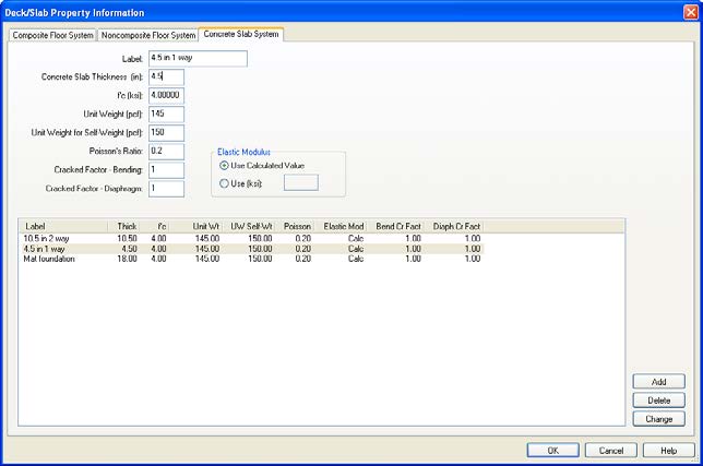

On the Concrete Slab System Tab, define three concrete slabs.
Type 4.5 in 1 way for the Label.
Type 4.5 (115) for Concrete Slab Thickness.
Click [Add] and the information will be added to the large window.
Type 10.5 in 2 way for the label.
Type 10.5 (265) for Concrete Slab Thickness.
Click [Add].
Type Mat Foundation for the Label.
Type 18 (450) for Concrete Slab Thickness.
Click [Add].
- Type 12 in cap for the label.
- Type12(300) for Concrete Slab Thickness.
- Click [Add].
Click [OK].
You have now defined the decks/slabs to be applied to the floor plan.
A few notes on decks: ANY Steel members that are under ANY portion of two way deck will not be completely designed. This means that any force coming from the two way slab will be lost to the steel member. Decks can be used as supports for columns, therefore gravity and lateral forces can be applied to other members through the diaphragm. Keep this in mind when placing lateral members in particular as the deck must be meshed to transfer the lateral loads in RAM Frame. Walls cannot be supported by any deck.
We will now apply the decks to the 2nd floor type.
- Select Layout - Slab - Deck Assign.
- Select the Two-Way option under Slab Action.
- Select the Concrete Framing System Option
- In the list box, highlight the 10.5 in 2 way slab that you defined in the previous step.
- Click [Whole Diaphragm].
- Click anywhere inside the region enclosed by the slab edge (a diaphragm). Do this for both diaphragms on this floor type.

With the "+" cursor, click at each of the corners of the slab edge around the steel beams that make up the atrium canopy. A continuous white line should appear as you trace out this polygon. Once the polygon is closed the area will be hatched differently that the concrete slab area.
3rd Level Deck Areas
The entire floor, except the slab openings, should now be hatched indicating the slab placement. (If the program does not display the deck, it means your slab edge or one of the slab openings are not closed properly. Return to fix that now.). The deck itself is always truncated to the slab edge so it is fine to add deck areas larger than the floor plan as you did here. By making the deck extra large you are assured that the correct deck extends out to the slab edge overhang. This is recommended to prevent unwanted decking on the overhang that might incorrectly brace the perimeter beams.
The points that define the deck or slab assignment area can also be established using the Keyboard Mode Coordinate Entry dialog box that appears on screen. The X and Y fields are related to the global coordinate system of the model. Once you have established a node of the deck polygon, those values can also be used to generate an offset, or relative displacement, for the next node. The dialog box can be moved if it is in your way when graphically selecting points.
You can also alter the deck polygon by using the change polygon command in the Deck Assignment Mode dialog.
We will demonstrate that by separating the main concrete deck from the noncomposite deck.
- Right click to return to the Deck Assignment Mode dialog.
- Click [Change Polygon].
- Click anywhere inside the main floor diaphragm and a solid white line will now be encompassing the entire floor. Click on the bottom left hand side of the box at the white node. Click again to move the node to the bottom left slab edge.
- Move the cursor to the midpoint east of the newly moved node. A midpoint node will appear. Click on it and move it to the slab edge near B-1.
- Continue this until the deck polygon looks like this:
3rd floor type concrete deck polygon

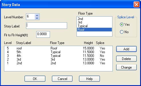

Story Data
With all of the floor types defined, you can now designate the arrangement of these floor types in the building. This is called the story data:
- Select Story.
- Type 2nd for Story Label.
- Type 13 (4.25) for Flr to Flr Height.
Note: It is recommended to enter the deck/slab support elevation difference between stories (Top of Steel-Top of Steel) when entering the story height data.
- Highlight 2nd in the Floor Type list box.
- Select Yes for Splice Level.
- Click [Add].
- Type 3rd for Story Label.
- Highlight 3rd in the Floor Type list box.
Note: Since there are sloping columns on these two floor types, the program will place splices automatically during column design if not selected here.
- Click [Add].
- Type 4th for Story Label.
- Type 11.5 (3.75) for Flr to Flr Height.
- Highlight Typical in the Floor Type list box.
- Select No for Splice Level.
- Click [Add].
- Type 5th for Story Label.
- Type 11.5 for Flr to Flr Height.
- Select yes for Splice Level.
- Click [Add].
- Type Roof for Story Label.
- Type 15 (4.75) for Flr to Flr Height.
- Highlight Roof in the Floor Type list box.
- Select Yes for Splice Level. (the splice above the top level does not matter)
- Click [Add].
- If your data appears like the figure above Click [OK], otherwise highlight the incorrect level, modify the required settings and click [Change].
A full 3-D model of your structure has now been developed, albeit not quite complete. To view your 3D model:
- Select View - 3D-View.
You should now see a 3D view of your model. Feel free to investigate some of the features in the 3D Viewer.
- Press the arrow keys on the keyboard to rotate the model or hold down Ctrl and move the mouse to rotate.
- Press the F2 function key to see other keyboard shortcuts.
- To exit 3-D View and return to Plan View, select File - Exit.
Note: the environment and interface of the 3D view is also used in some of the design modules.

First we'll modify the height of the columns.
- Select Layout - Columns - Modify Elevation.
- Set the Top of Column to extend and type 2 (0.75) for the value.
- Click [Fence].
- In the graphics mode, fence all of the columns on Grid 3.
- Right click to return to the Modify Column Elevations dialog.
- Change the value to 4 (1.5) and Fence the Columns on Grid 4

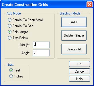

Construction Grids
In addition to these two grid systems, the model also needs a few construction grids to aid in the modeling of certain features. Construction grids are useful for modeling loads or deck areas that do not fall exactly on the framing. Construction grids will not appear in any other design module and they are not labeled. To create a construction grid:

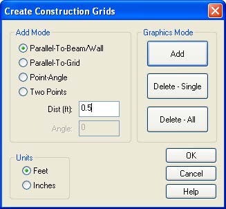

- Select Layout - Grids - Construction Grids.
- With the Add Mode set to Parallel-To-Beam/Wall type 0.5 (0.15) for the distance.
- Click [Add].
- With the cursor, select any of the beams along Grid A.
- Two parallel white lines 0.5 ft from grid A5 will appear. Click on or near the west (left) line to create the new grid at that location.
- Repeat for Grid F.
- Right click to return to the Construction Grids dialog box.
- Change the Add Mode to Point-Angle
- Set the angle to 0 degrees, set the distance to 0.
- Click [Add].
- With the "+" cursor, click at the grid coordinates A-2 and A-3.
These construction grids will aid in laying down the different deck planes.

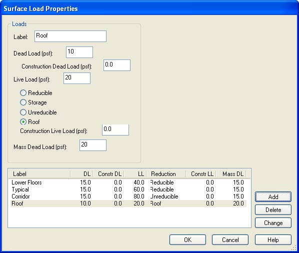

- Change the Label to Roof
- Change the Dead Load to 10 (0.5)
- Change the Live Load to 20 (1)
- Change the type of load to Roof.
- Change the Mass DL to 10 (0.5) or 25(1.25) (no mass included).
- Click [Add].
- Click [OK].

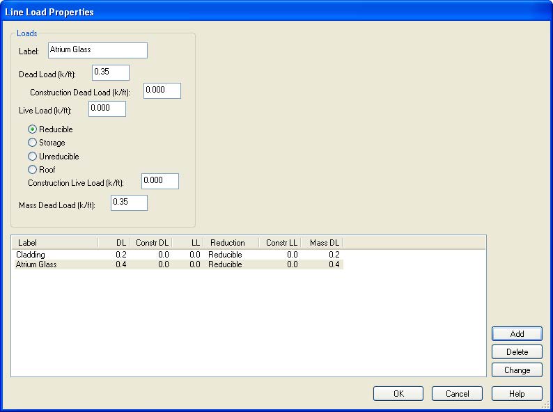

To define the Line Loads:
- Select PropTable - Loads - Line. The Line Load Properties dialog box should appear:
- Type Cladding for Label.
- Type 0.2 (3) for Dead Load.
- Type 0.2 (3) for Mass Dead Load.
- Click [Add].
- Change the Label to Atrium Glass.
- Change Dead Load and Mass Dead Load to 0.4 (6).
- Click [Add].
- Click [OK].

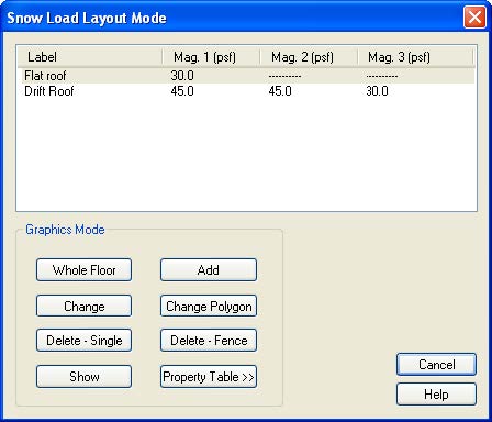

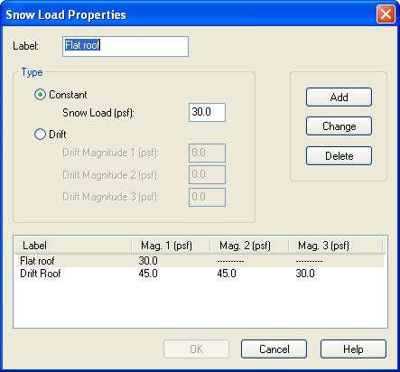

To define Snow Loads:
- Select Property Table - Loads - Snow.
- Type Flat Roof for the Label.
- Set the Type to Constant.
- Enter 30 (1.5) for the Snow Load magnitude.
- Click [Add].
- Change the Label to Drift Roof
- Change the Type to Drift

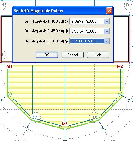

- Enter the three magnitudes 45, 45 and 30 (2, 2, 1.5).
When you layout the loads you can choose which corner of the load should be associated with the values entered here. The snow loads you apply may have more than 3 corners, but only three are required to define the load plane. - Click [Add] and click [OK].

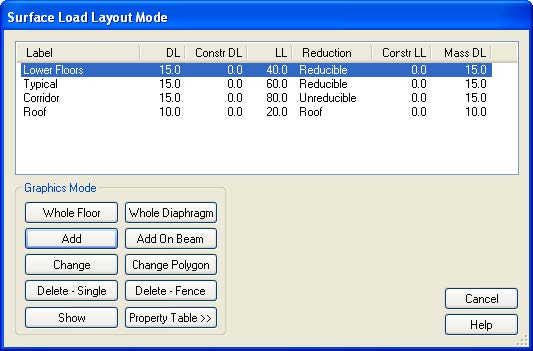

Now that the loads are defined, it's time to apply them to the floor.
- Select Layout - Loads - Surface Loads.
- Highlight Lower Floors from the list box in the Surface Loads Layout Mode dialog box.
- Click anywhere inside the diaphragms to add the load.
You should see the two floor diaphragms covered with a hatch pattern. At this stage you have the floor load over the entire floor area. You could now place other loads over a portion of the floor (as in the case of corridor, storage or equipment loads) and those loads would supersede (replace) the floor load in that area. Surface loads are not cumulative.
- Select the 3rd Level type.
- Right click to return to the surface loads dialog box.
- Ensure the Lower Floors load is selected and click [Whole Floor].
- Right click to return to the assign dialog and select Corridor
- Click [Add].
- Click at the four corners of the corridor defined by the grids C-2, C-5, D-5 and D-2.
Snow loads are applied in much the same way as surface loads.
- Select Layout - Loads - Snow.
- Select Drift Roof load type
- Click [Add].
- Start by clicking at the upper left corner of the canopy, then select the upper right corner, then continue around clockwise around the slab edge close the polygon as indicated below.

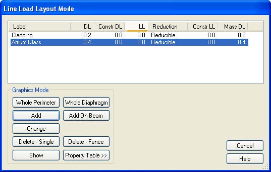

- Select Layout - Loads - Line Loads.
- Highlight Cladding load from the list box.
- Click [Whole Perimeter].
A line indicating the load will appear along all perimeter beams. The line will be broken up into segments, but this not a requirement when modeling line loads.
- Right click to return to the Line Load Layout Mode.
- Click [Delete - Fence].
- Fence the entire atrium to delete the line loads on the beams enclosing it.
- Highlight Atrium Glass in the List
- Click [Add].
- Trace along the perimeter Atrium beams.
- Assign the Typical load to the [Whole Floor].
- Repeat the steps above for adding a Corridor load to this level.
- Select Layout - Loads - Line loads.
- Repeat the steps above for adding the Cladding load to the Typical level.
- Select the Roof level type.
- Assign the Roof surface load to the [Whole Floor].
- Select Layout - Loads - Line Loads and assign the Cladding load to the [Whole Perimeter].

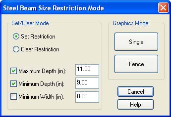

- Set the Current Material to Steel.
- Select Layout - Beams - Size Restrictions.
- Check the Maximum depth limit and set it to 11 (275)
- Check the Minimum depth option and set it to 9 (225).
Note: These limits are literal limits on the beam depth. We are using a depth range here to insure that we get nominal 10" beam.
- Click [Fence] and fence the entire Atrium canopy.
Note: While you are in the Steel material mode you cannot alter concrete beams.
- Repeat this for the 3rd story level Atrium beams.

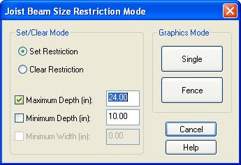

- Set the Current Material to Steel Joist.
- Right click and to return to the Size Restriction dialog.
- Check to use only a Maximum Depth of 24 (600).
- Click [Fence] and select all of the joist girders on Line 3.
Note: For joist girders, the maximum depth field is used explicitly in labeling the member. These joists will not be deeper than 24", they will be exactly 24" deep. For more on the design labeling of joists and joist girders, refer to the online documentation for the Steel beam module.
Brace Points
In the design of steel beams, the program automatically determines the unbraced length of the top and bottom flanges. When a beam frames into a girder, that girder is braced on the top and bottom flange at that location, but when a joist frames into a girder, only the top flange is braced by default.
- Set the Current Material back to Steel.
- Select Layout - Beams - Brace Points.
- Type 5 (1.6) for the Distance from selected span end.
- Check the Braces Bottom Flange box only.
- Click [Add].
In the graphics mode, select one of the frame beams on Grid Line 4 and then pick at the left end. A yellow triangle on the underside of the beam will appear. If top brace points are placed, the triangle would appear on top.
- Repeat for the other end of the same lateral beam.
- Repeat for both ends of all the moment frame beams on Grid 4.
- Right click to return to the User Brace Point Layout dialog
- Change the Distance to 10 (3.2).
Continue adding brace points until there is one at or near each joist location on all lateral moment frame beams. If you make a mistake select Edit Undo or use the Delete brace point option and remodel.

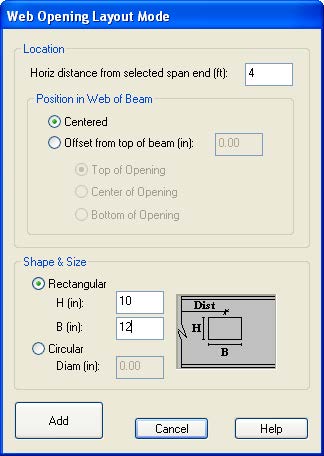

Steel beams can have openings modeled in the web. The size and the location of the opening must be specified, but then the program can optimize the beam and the stiffener plates (when required). To model an opening:
- Select Layout - Beams - Web Openings - Add.
- For the Location, set the Horiz distance to 4 (1.25).
- Set the Position in Web to Centered
- Set the Shape and Size to Rectangular
- Make the opening 10 (250) high by 12 wide (300).
- Click [Add].
- With the target cursor, select each one of the steel beams in the bay from E to F, 2 to 3.
- Pick the west end of those beams to place the opening relative to that end.
- Repeat for the rest of the beams indicated below.

The next step in the layout of this structure is to define the vertical bracing system. The layout of vertical bracing is performed in the elevation mode of the Modeler.
- Select View - Elevation Mode.
- With the cursor, select the frame on Grid A by selecting the Frame Beam or Shear wall. An elevation of your frame will appear. Only the lateral members are displayed in this view.
In elevation mode, a new menu of commands is available to you. While some of the commands from plan mode are included, other commands, such as Layout - Braces, are unique to elevation mode. To add braces:

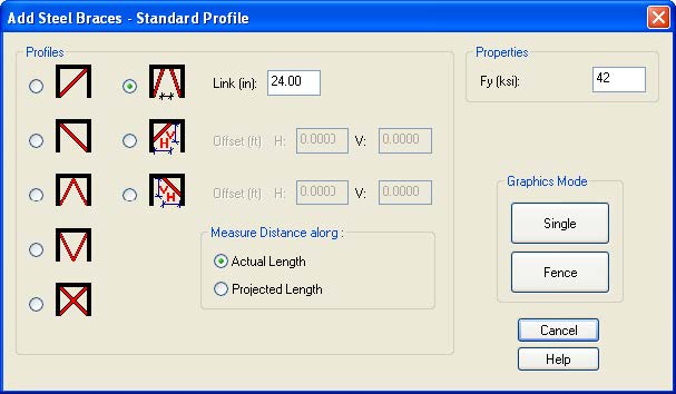

- Select Layout - Braces - Add Standard.
- Select the first Profile on the right for EBF braces.
- Enter 42 (290) for Fy
- Enter 24(600) for Link.
- Click [Single].
This will take you back to the elevation view:
- With the target cursor, click in the middle of the bay defined by the columns and beams of the 4th level up to the Roof level.
- Select View - Plan Mode to return to the Plan View.
- Select View - Elevation View and pick the Frame on Line F.
- Select the 3rd (Inverted V) shaped profile.
- Enter 46 for Fy (315 for py)
- Click [Fence].
- Fence the bottom two steel frames to put the inverted V braces in the middle two levels.
- Right click to return to the add braces dialog.
- Select the standard "V" (the 4th profile) formation
- Click [Single].
- Add this to the top bay of the frame.

Assigning Lateral Member Sizes
The RAM Steel Beam Design and RAM Steel Column Design modules optimize the design of the steel gravity members. It is not necessary to assign sizes to these members. However, if you want the program to use (check) a specific size for a particular gravity beam, the Assign Sizes command can be used to assign a size to an individual gravity member. The selected member size would be checked for adequacy and no design optimization will be performed for that member. If the steel beam is specified as composite then RAM Steel Beam Design module will determine the number of studs required to meet the design criteria.
The lateral analysis performed in RAM Frame, on the other hand, requires that preliminary sizes be assigned to the Lateral members in order to analyze those frames. The preliminary sizes can be assigned manually in the RAM Modeler using the Assign Size commands, in RAM Frame using similar Assign Size commands, or member size can be left out and the program will then automatically assign a size adequate for the gravity loads only when the RAM Steel Beam and RAM Steel Column modules are executed.
- Select the elevation view of the braced frame on Grid A.
- Select Layout - Beams - Assign Size.
- From the list of sizes, select a W12x22 (UB305x102x33).
Note: You can simply type the section name in the box above the list or browse to it.
- Click [Fence].
- Fence all the beams of this frame.
- Select Layout - Columns - Assign Size.
- From the list of sizes, select a W10x33 (UC254x254x73)
- Click [Fence].
- Fence all the columns of this frame.
- Select Layout - Braces - Assign Size.
- From the list of sizes, select a HSS5x5x3/8 (SHS120x120x6.3)
- Click [Fence].
- Fence all the braces of this frame.
- Repeat the same steps for the braced frame on line F.
- With the cursor, select the frame on Grid 4.
- Select Options - Show Property - Frame Number. This command will cause the frame numbers of each member to be displayed on the screen. Having these active while you make frame number assignments provides visual confirmation.

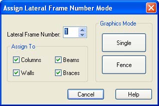

- Select Layout - Frame Numbers.
- Check all four settings for Columns, Beams, Walls and Braces.
- Type 1 for Lateral Frame Number.
- Click [Fence].
- Fence the entire frame. The frame numbers will change from 0 to 1. Any lateral member that is not assigned a specific frame number is, by default, set to be part of Frame 0.
- Label the other frames as follows:
Braced Frame on Line A is #2,
Braced Frame on Gird F is #3.
(Refer to 3rd Floor Framing, Figure 1 at the top, at the beginning of the Modeler section).

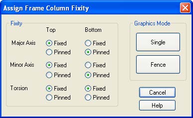

- Select the Elevation View of the Frame on Line A.
- Select Layout - Columns - Assign Frame Fixity.
The Assign Frame Column Fixity dialog box should appear. It has two sets of option buttons that give you the choice of setting the column ends to fixed or pinned. One set is for the top of the column and the other for the bottom.
- Set Major and Minor Axes of the Bottom to Pinned.
- Click [Single].
- Select the third level columns (the bottom level of steel). Notice that the fixity display changes.
- Repeat for the braced frame on Grid F.

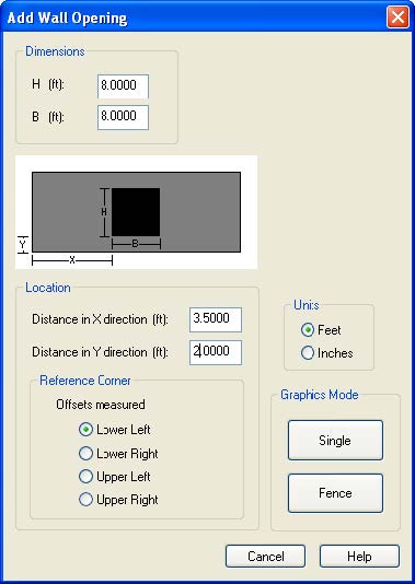

Wall Openings
A lateral wall can be modeled with openings. Opening for doors and windows can easily be placed in the walls. Openings can also be modeled that cross the edge boundaries of wall elements, but if the top edge of the wall is going to be clipped by the opening we recommend that the wall be split into separate pieces. Otherwise the floor framing might frame into the opening. To model an opening:
- Select View - Elevation Mode and select one of the walls on line 2.
- Select Layout - Walls - Wall Openings - Add.
- For the Dimensions, type 8 (2.5) for H and 8 (2.5) for B
- For the Location, set the Reference corner to the Lower Left
- For the Distance in the X direction type 3.5 (1.2)
- For the Distance in the Y direction and 2 (0.75).
- Click [Fence].
- In the graphics mode, select all the walls in the view.
The opening will show as a black rectangle on the wall near the middle of the wall. The opening is tied to this wall and if it should be altered (due to a change in the story height or a modification to the grids for example) then the opening will maintain its position to the Reference corner. When an opening spans across more than one wall segment, it is still associated with one wall or the other.
- Re-enter plan mode, then select the walls on Grid F to add a "Doorway" to the lower wall.
- For the dimensions use H=8(2.5), B=6(2), X=9.5(3), and Y=0.
- Click [Single].
- Click on the lower of the 2 walls.
Wall openings can be changed using the command Layout - Walls - Wall Openings - Change. They can also be deleted or reviewed using the delete and show options respectively. The wall openings are assigned numbers and the numbers can be shown using Options - Show Property - Wall Opening Numbers.

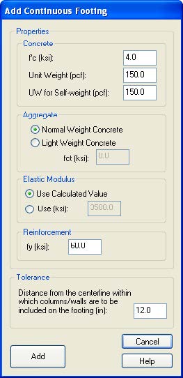

Ensure the Floor type is set to 2nd.
Select Layout - Foundations - Continuous - Add.
Set the f'c to 4 (30).
Set Unit Weight to 150 (2400).
Set UW for Self-weight to 150 (2400).
Set Fy to 60 (410).
Click [Add].
In the graphics mode add a continuous footing by clicking once at Grid A-3 and again at Grid A-5.
Add another footing under each of the lateral frames.

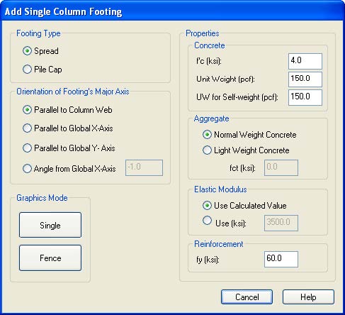

Select
Layout - Foundations - Single Column - Add.
Select all the same variables used with the continuous foundation.
For the Orientation of the Footing's Major axis, use Parallel to Column Web.
Click [Single].
Add a footing under each steel column and also the concrete columns on the perimeter.
Right click to return to the Add Single command.
Change the Footing Type to Pile Cap and click [Fence].

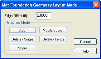

Select Layout - Foundations - Mat - Geometry.
Type 2 (0.75) for the Edge Offset and click
[Add].
With the cursor, click at each of the 4 corners of the 2 elevator shafts. The program will add the perimeter of the mat foundation to an area 3' larger than the pit on all sides.

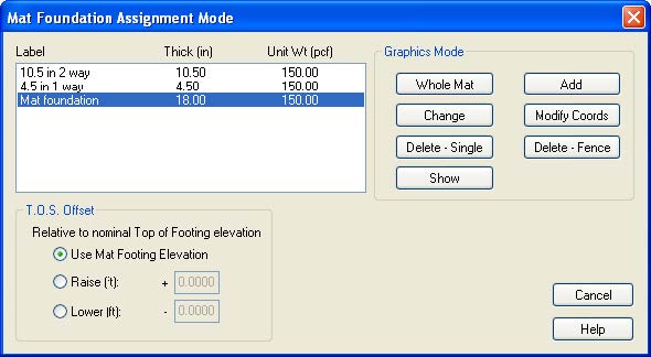

Select
Layout - Foundations - Mat - Properties.
Select the Mat Foundation
Click [Whole Mat].
In the graphics mode select anywhere within the mat perimeter and it should be filled in with a hatch pattern.
Note: Mat foundations are currently not designed in the RAM Structural System. Due to the increased interoperability of the program a mat foundation can exported to RAM Concept, for example, to be designed for loads determined by the foundation program.
