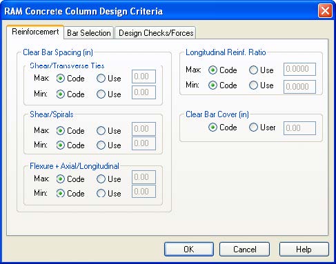

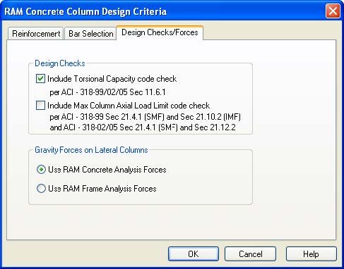

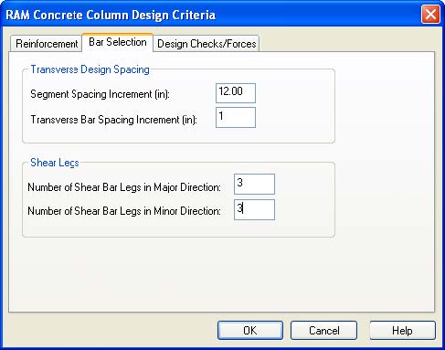

Column Design Criteria
The program has an extensive set of design defaults to customize the way concrete columns are designed and detailed. To set up the column design defaults which will be used for all columns in the model:

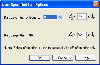

The other design criteria for Reinforced Concrete Columns is the Lap Spacing which can be customized.

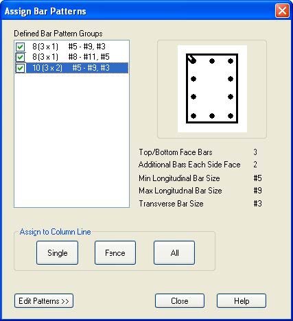

Assign Bar Patterns

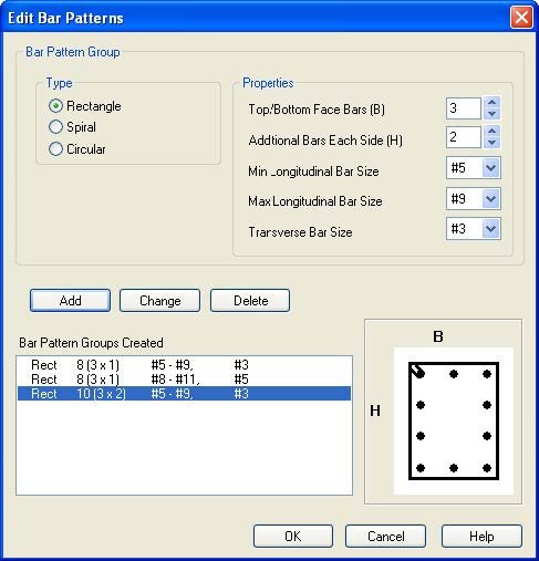

Before the Columns can be designed we must specify a bar patterns that we wish to use. You can define any number of bar patterns or layout and the program can consider up to three of these layout for each column that it designs. To define the bar patterns:
For this example we will define three bar patterns.
A new line of data will appear in the Bar Pattern Groups Created list box.
Now the bar patterns we just defined must be assigned to the concrete columns in the model. To do this:
NOTE: As you click on each bar pattern the graphic and data to the right are updated to provide a description of that bar pattern.
NOTE: You can access the Edit Bar Patterns dialog box directly from this window as well.

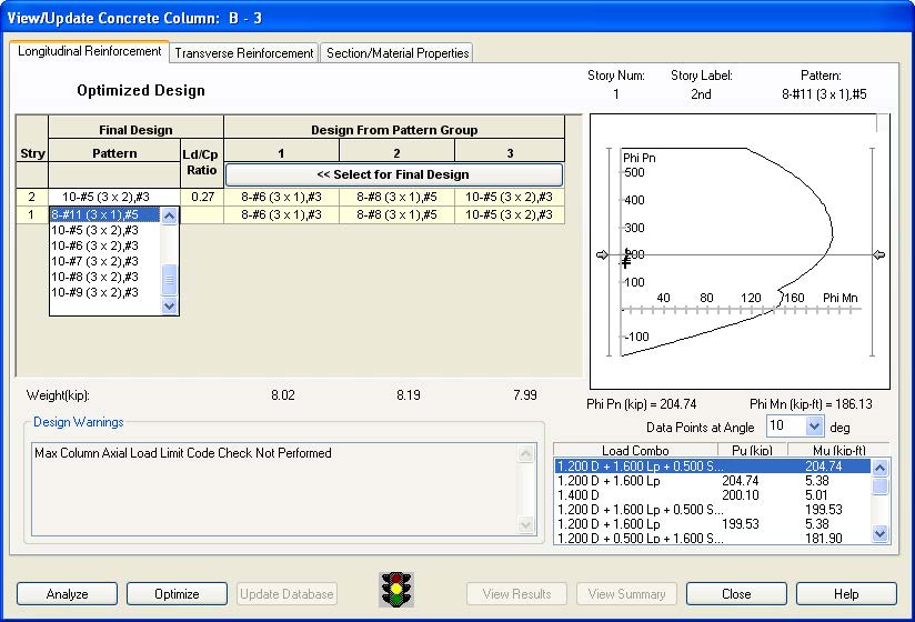

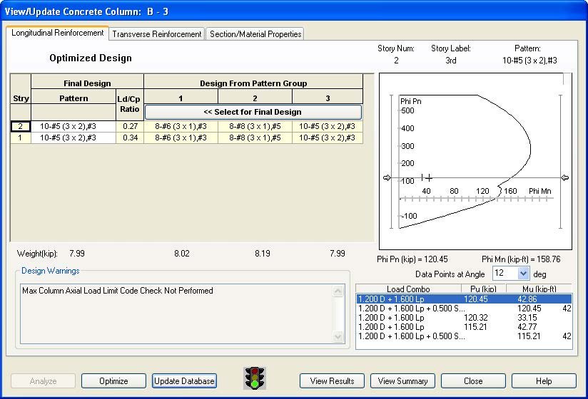

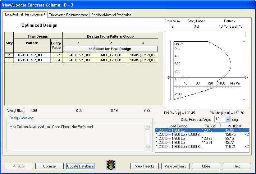

The View/Update dialog box will open. There are many options available to in this dialog. For a complete explanation of the View/Update window see the RAM Concrete manual.
The Column View/Update dialog box is separated into three tabs for Longitudinal Reinforcement which is initially displayed, Transverse Reinforcement and Material Properties.
The program determined bar pattern is listed in the upper left corner. This reflects the optimum working design from the assigned bar pattern groups. The design can be changed by simply clicking in the cell with the design and picking another set of bars.
On the right side is an interaction surface for the currently selected level of the column. The program creates an interaction surface for each 2-degree increment around the column. When designing the column, the program investigates each data point (a set of axial forces and moments from a particular load combination or pattern). The data point that is closest to the interaction surface is the point initially shown in the diagram.
At the bottom of the widow is an area for design warnings related to longitudinal reinforcement. There is a separate area for transverse design warnings on the second tab.

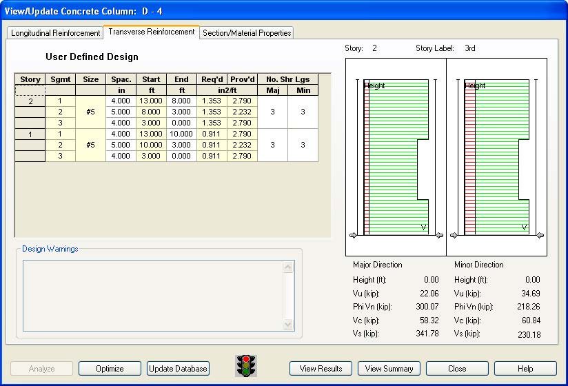

The lateral columns in this model have many more design requirements, not only because of the additional loads, but also because they were designated as Special Moment Frames.
In this case, the program selects one of the bar sets with #5 ties. To review the transverse reinforcement click on the Transverse Reinforcement Tab.
Notice that the shear reinforcement has to be quite concentrated near the ends of the column in order to meet the special detailing requirements of the code.
